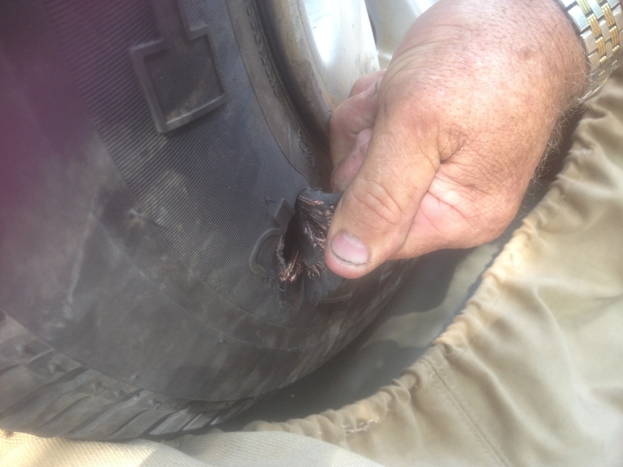

I lost a HT tyre at Krokodilberg in Feb. Long story. Was experimenting with different tyres. The bottom line was that the sidewall got a whole the size of a R5 coin. Sure you can blame me and blame my co-driver (left rear wheel). But mistakes happen. The tyre was damaged beyond what a patch can fix and it happened instantly. It may have been less likely with an MT, but all you need is a rock sharp enough. TPMS would have been no help here.
