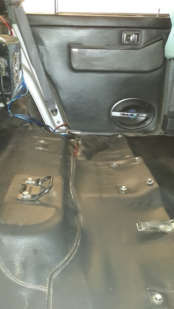

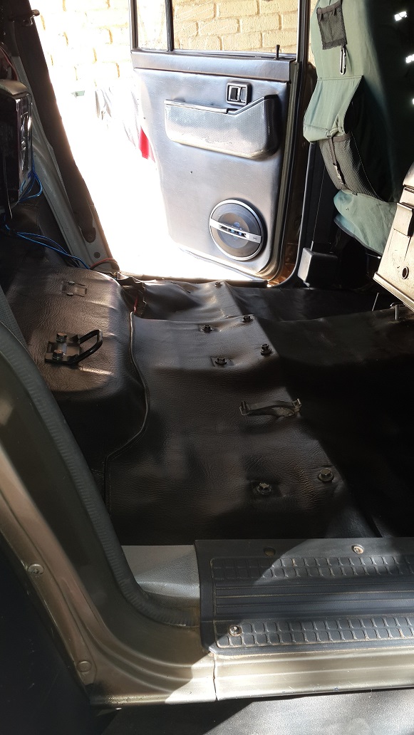

Seeing that the drawers system with the kitchen and 2 32L are already in the back of the vehicle the only remaining place would be in the rear passenger "space".
I took out the two rear benches entirely and was planning to put in a complete "deck" to level the floor, but then decided to only put it in the place of the bigger seat so that if required I can still fit a third seat (we are a family of three so this made more sense).

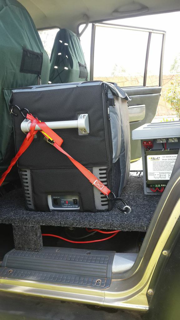

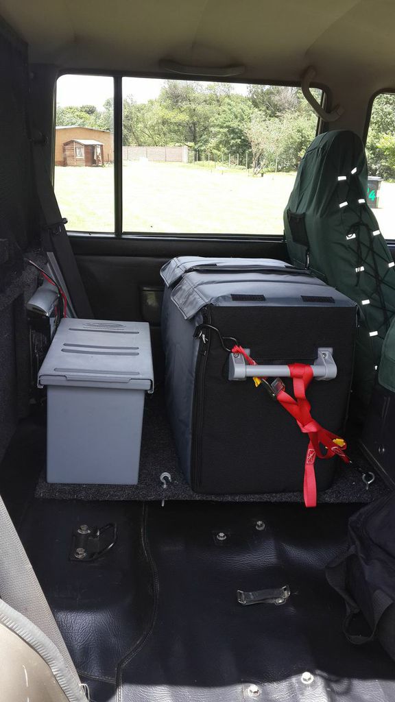

Cut out a deck and covered with carpet drilled some holes in to not only fit properly to the vehicle itself but also to be able to properly tie down the fridge itself.
Fitted the deck and then the battery box with the DC-DC charger and the fridge with easy access for the front passenger.
Also fitted the required cabling running from the main battery to the back.
Took me two days but can be done in a couple of hours if everything is ready and available.......
Seat removed
Seat removed
All seats removed
All seats removed
New fridge and DC-DC from driver side
New fridge and DC-DC from passenger side

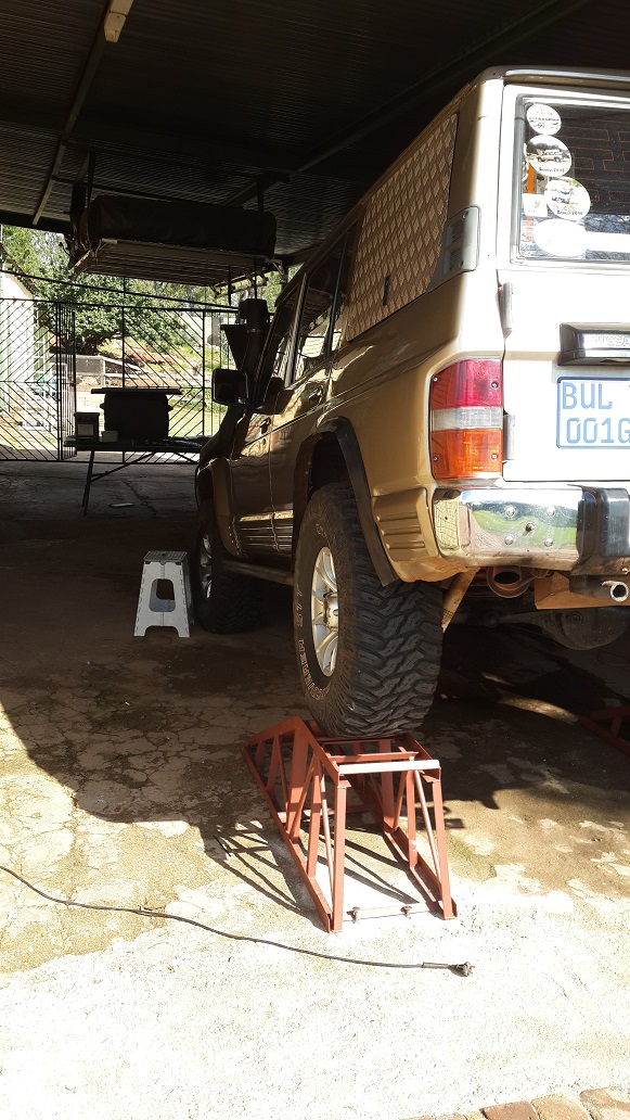

Lifting to get underneath to make sure all is properly fitted and tight and run the required cabling.
