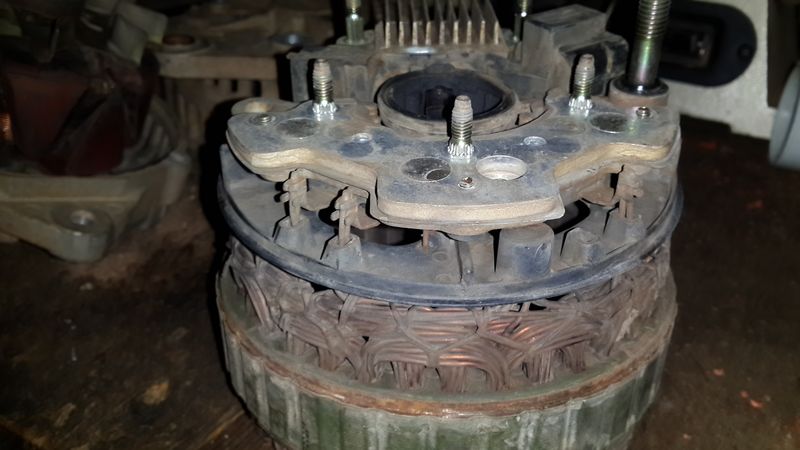

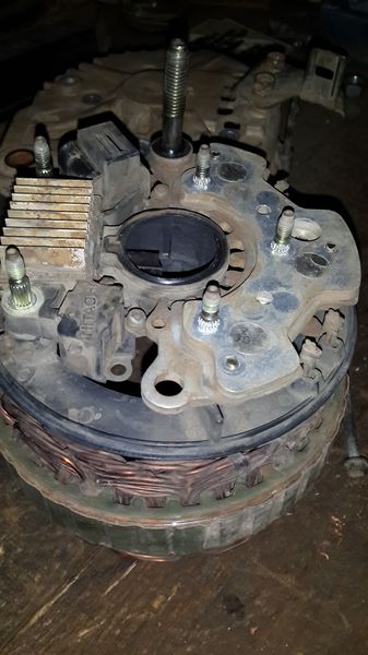

Last week, we had some bad luck with the Patrol ('99 4.5 GRX) breaking down while my wife was picking up the kids from school, while I was away for business in another province. :redface:
It became apparent very quick that the alternator was the culprit. The regulator and diodes were shot. A quick couple phone calls wasn't looking promising, with no-one having stock. Luckily the local auto electrician had a generic nissan alternator on hand that he could fit within a day to get us going, and at R2800 it seemed not too bad for a new alternator, fitment and fan belts.

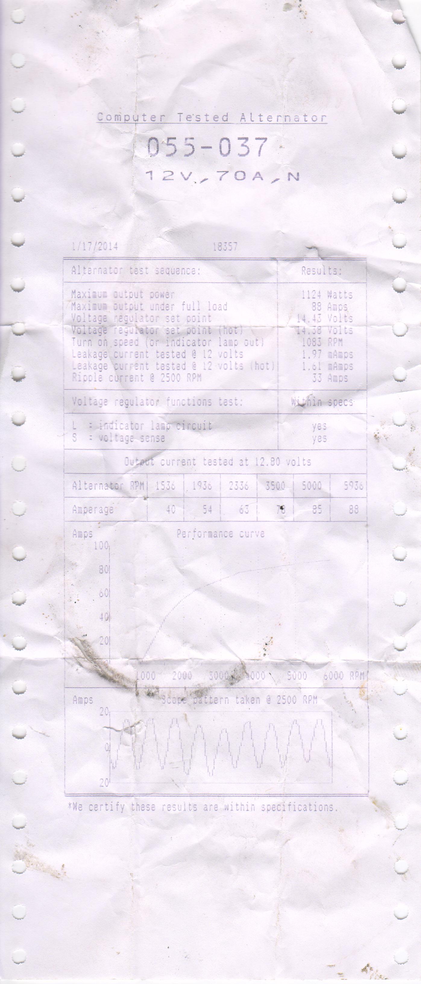

I think the new alternator is similar in specs to the original Hitachi of in the region of 70A. See the test sheet of the new alternator below
Generic Alternator Test Results
New Alternator Test Specs.jpg (413.51 KiB) Viewed 3454 times
I still have the old alternator, what is your recommendation:
1) Repair and re-install the original, keep generic as spare
2) Repair and store original as spare
3) Do nothing further, keep generic installed and the broken Hitachi in the garrage for just in case?

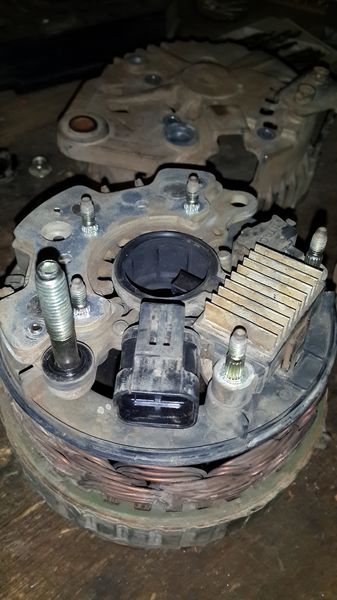

If I proceed to repair the Hitachi, where can I obtain the diodes and rectifier and what would the costs be? I would assume that I should replace the bearings as well?

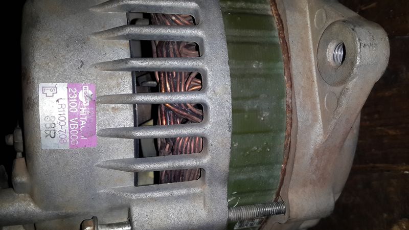

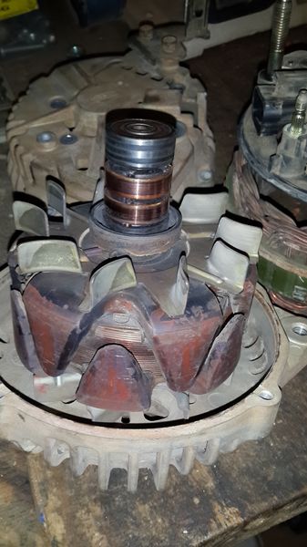

I have taken some pictures of the stripped Hitachi alternator:
Hitachi Alternator showing diodes and rectifiers from side, including connection to stator
Hitachi Alternator showing rotor assembly
Hitachi Alternator showing diodes and rectifiers from top
Hitachi Alternator showing diodes and rectifiers from top/side
Hitachi Alternator showing part/model numbers Enlarged

I bought a pirate a few years back for about R1 100. Served me well. No problems. In fact, provides better current than the Hitachi did. I thought th Hitachi was 90A?
Gave the old one to Peter to "find a good home for" and never thought about it again.
If you are sure the windings and brushes etc is ok, and a new one price upwards of R2000, then replace the reugalator unit and sell it to the next bloke in need. If he funds half of your alternator replacement and alternator repair costs, both of you are in a better position.
To keep it as a spare - That will be unwise, as your new alternator will last a number of years and by the time you start searching for the spare you kept in the garage, you may very well find your son used it for a "science" project.... Rather give it away as is instead of keeping it for a spare.
That's my opinion, in now way any authoritive stamp on the matter.

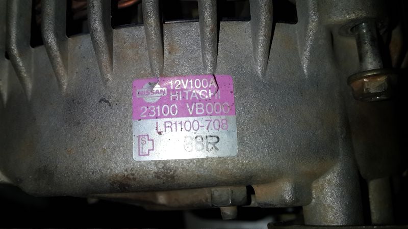

Your new alternator is 70 A/h (says so on the paper)
The old one was 100 A/h (says so on the label).
I would be worried about a 30% drop in uotput. Ideally, test your maximum consumption by using a clamp meter and running all possible ancilliaries at the same time (brights, air con, dual battery charging system, etc). If your vehicle can draw more than 90A/h, I would replace the pirate.
Whether the replacement for the replacement is another pirate of higher output, or a repair of the original, depends on cost...
:mytwocents:

I did not even notice the 100A on the Hitachi. :doh:
