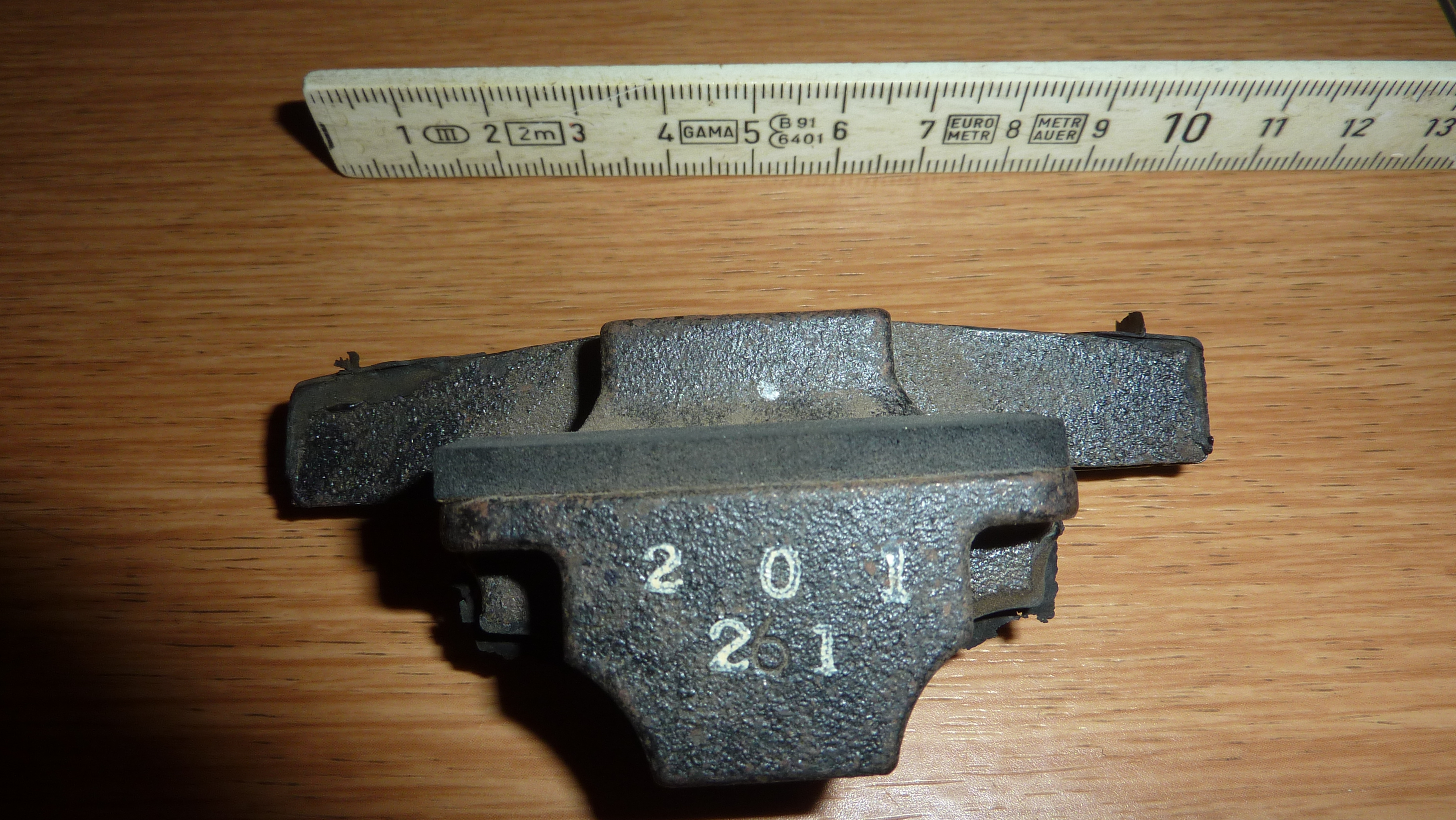

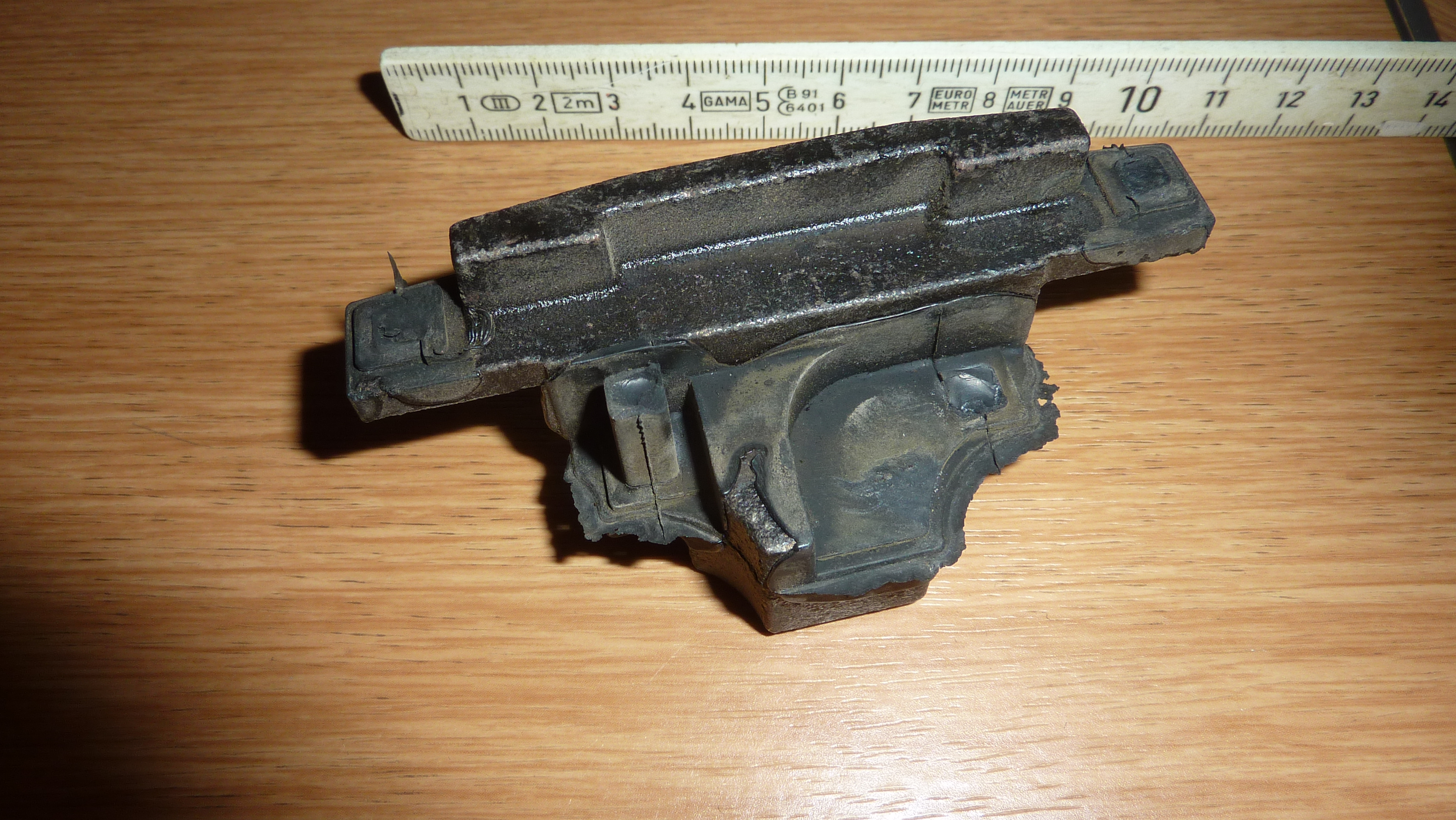

This is for the Patrol GU 1998 GL
I had a rattle in the steering wheel with a metallic sound on bumpy roads.
When removing the airbag I found this metallic piece hanging lose by some remain of a rubber suspension.
I don't know and cannot figure out its function or eason th be there so I removed it and drive without a rattle now again.
Anybody who can guess what this part is all about.
Removed this part from steering wheel

Counter weight for steering wheel.
