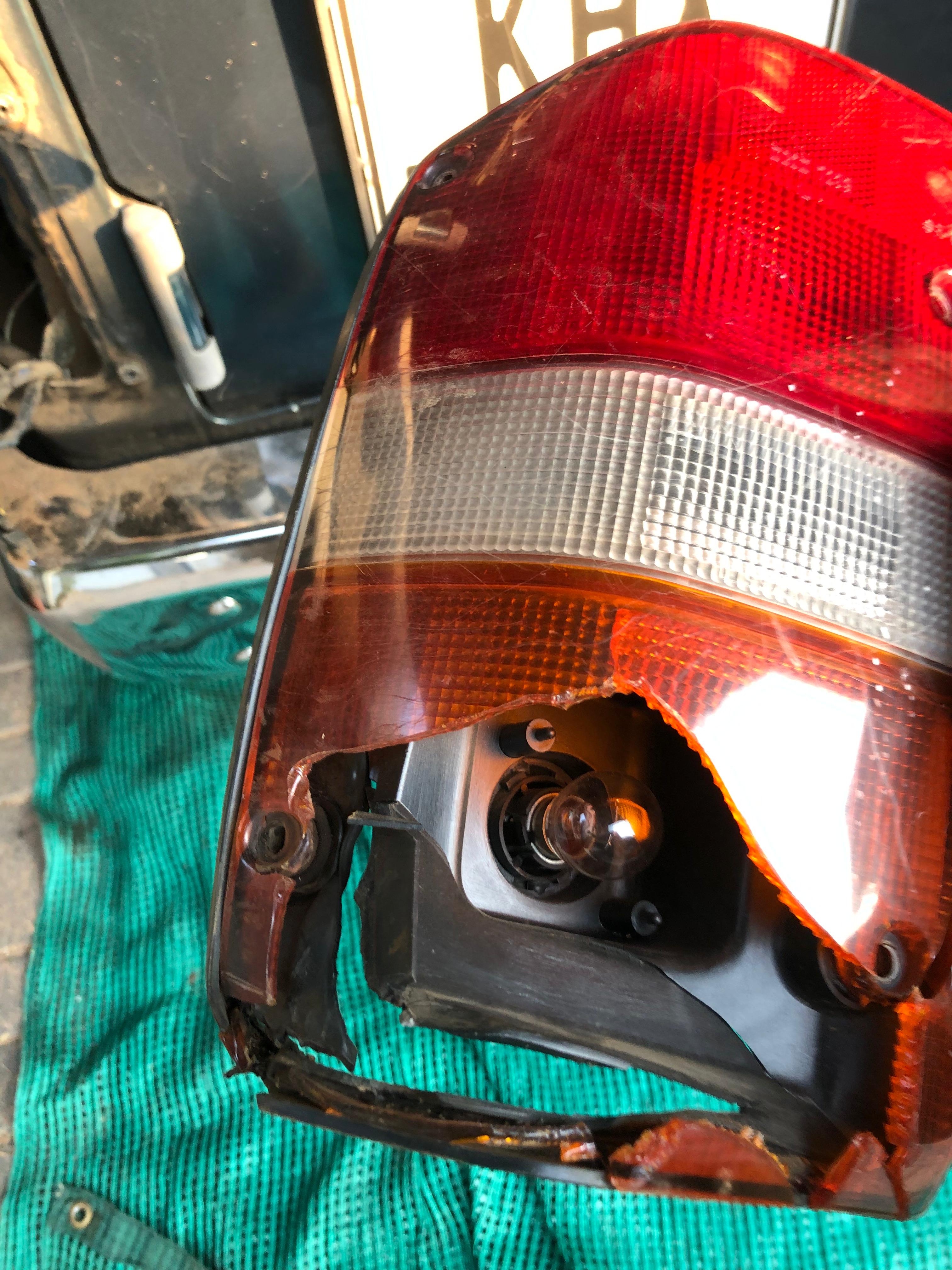

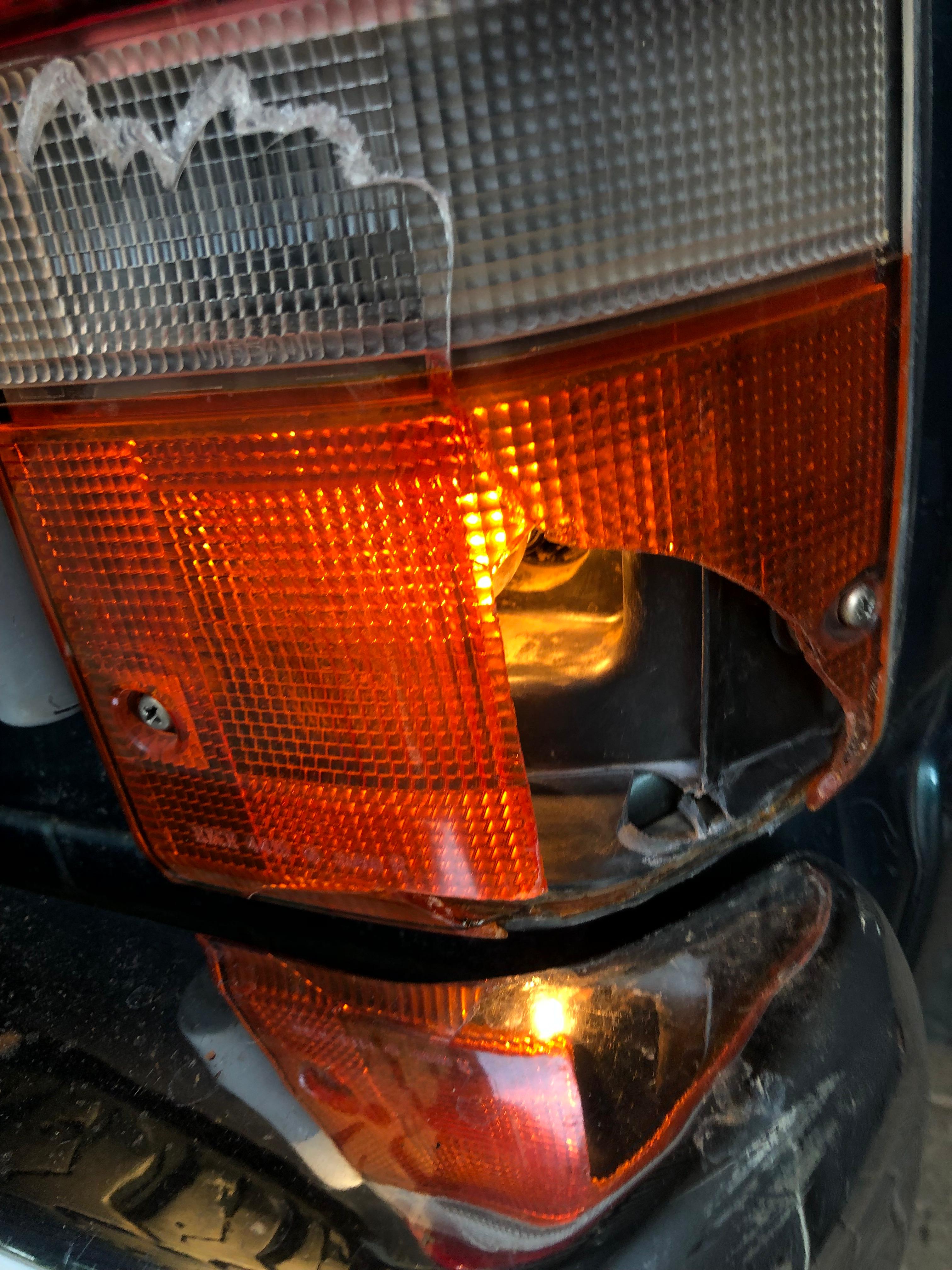

Let me piggy back on this thread with my issue:
After returning from river trip I noticed my indicator lights stopped working.
Before doing much troubleshooting I checked the fuse - yip the fuse for indicator circuit is burned.
Changed the fuse, problem solved... for now.
Drive to work, indicators work fine, but after a few turns they are dead again - fuse gone.
The problem seems to be on the right hand side, possible at the back. rear right globe lights up very dim, front seems fine. cabin light slightly dims in tune with the indicator lights (only when indicating to the right).
So obviously a short somewhere?
Now three things that happen in the river that could compromise the electrical system:
1. the tow bar electrical plug point got totally destroyed against a rock.
2. both my rear lights cover's got damaged due to driving over big boulders which knocked the rear bumper into the rear lights (on both sides on different occasions).
3. tip of my exhaust broke of (welded previously) - exhaust is now a bit shorter creating extreme heat on bumper underneath left hand side rear light. Hot enough to probably melt wires - but problem seem to be on the other side...
I disconnected the wiring from the towbar plug point and isolated each wire.
Swapped left and right globes - still problem at right.
Disconnected right light fitting, still noticed the cabin light dimming with the indicator light.
What else can I check?

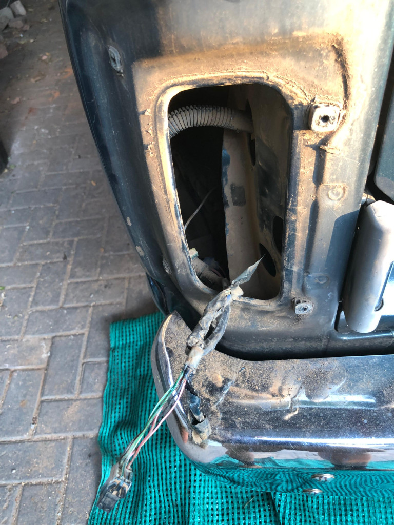

my trailer cables is feeding from the left.
since a piece of my exhaust broke off, I was wondring if the excessive heat maybe burned some of the cables.
So I removed the left rear light. Could not see any burned cables although the light fitting is slightly melted at the bottom.
I also loosened the tow bar cable to better inspect it. (cut all the cable ties and fed the cable into the space behind the light fitting - was considering to totally remove the cable as I never use my tow bar).
Tested the hazard and indicator lights - and now it is working..
So I am not sure if the problem was with the tow bar cable or the light fitting's connection - but it is working for now....
