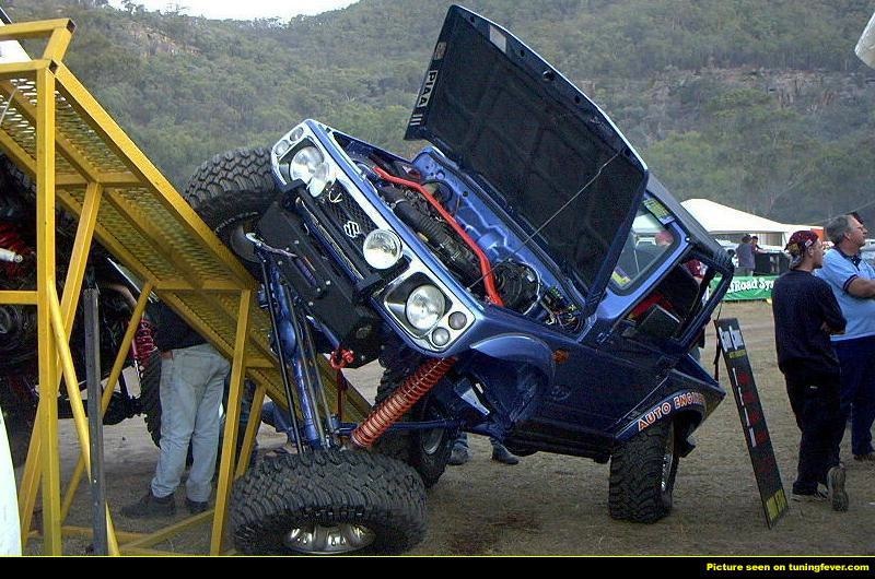

Hi Peter
Have a look at the picture below.
Note, both rear wheels are on the ground. That is a lot of flex. Yet, I do not see any holes in the bonnet for the shocks to come through.
Suze Super flex
Suze Super flex
In my own case, with the rear stabiliser now broken off, and the body lift, I guess I have space for the wheel to travel upwards.
So I suspect in my case I will still be limited by what the shocks can allow me to flex by?
But what about the break lines?

Alex, I saw this one too. It would be interesting to see what it looks like on flat ground.
The higher the lift, the less you have to move the shock mounts upwards (assuming that the upwards travel is limited)...
