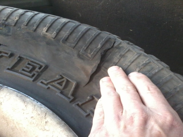

In eight years of off roading I have done little damage to any tyre, till three weeks ago I split open a HT that was donated to me just three days before. I had no grip the whole day and was sliding all over the place. I was also the only person they had to recover that day. Have to blame the tyres as another hardbody with less lift than mine got through the same place I had to be recovered.
HT's just don't offer the side wall protection a AT or MT will Personal experience is that MT's are the beesknees in any and especially unexpected terrain and circumstances, your trade off is they are fairly noisy and offer some additional rolling resistance on tar. I also got my best kilo's out of my MT's compared to any of my other tyres.
