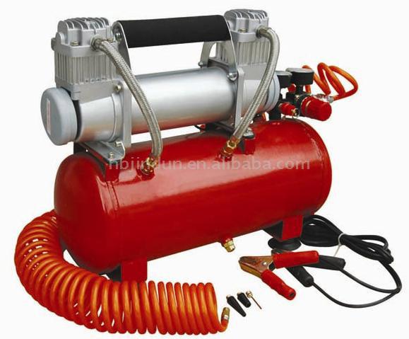

When I bought the Patrol, it came equipped with a compressor mounted in the engine bay. This is a single-head jobbie, and takes about 5 minutes per 12.5" x 33" tyre to raise the pressure from 150 to 200 kPa (1.5 -> 2 bar). 20 minutes may not sound long, but it is when you're done playing and just want to get on the road again. So I bought myself one of these compressor/tank combos from a place that closed their doors in Cape Town last year:
Complete unit, before!
Tank 150liter Dual Head Compressor.jpg (37.34 KiB) Viewed 4609 times

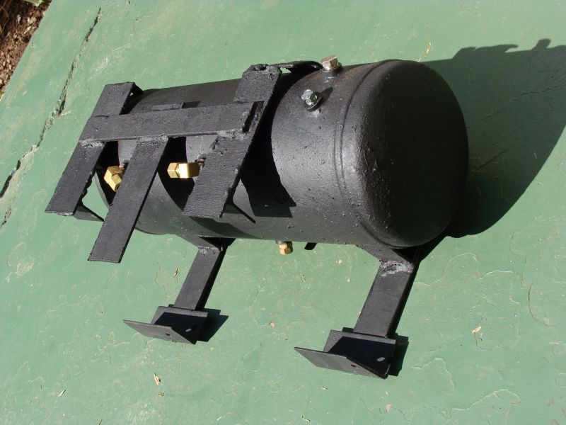

I liked the price (about R700), but not the size of the thing. It was more "luggable" than portable, and wasted a lot of space inside the vehicle. So I proceeded to take the whole thing apart so that I could mount the pump inside the back of the Patrol, and the reservoir tank underneath the car. My Patrol does not have the extra fuel tank, so I decided to mount the tank in it's place. I welded up a bracket that hooks over the top of the frame and rests against the bottom. Some extra bits of steel offer protection for the tank and fittings, and a layer of chassis paint made it a bit more durable. I pugged up all the holes leaving just two - one for incoming air and another for outgoing air. There's also drain screw at the bottom to release accumulated moisture from.
Tank prepared...
Tank prepared...

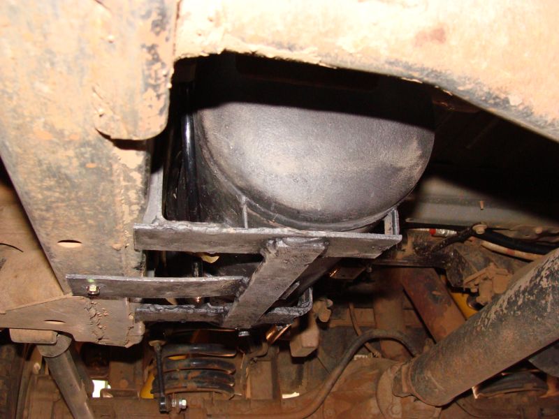

It fitted REALLY tight over the frame, and only needed a single Tek screw at the bottom to keep the bracket from moving backwards and forwards.
Tank fitted!
Tank fitted!

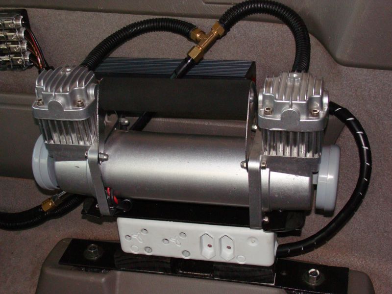

One of the pipes is connected to the pump, which is mounted on a bracket where the 3rd row seats used to be. The bracket also houses a multi-plug that's connected to an inverter that lives in the side storage area behind the pump and lifts the pump high enough for the air outlets to clear the storage bin. I retained the original fittings that exit the two pump "heads" (another non-standard size item), joined them together and fed them into a one-way valve (just visible behind the left-hand bottom of the pump). I also re-used the rubber feet when mounting the pump to the bracket to minimise vibration when the pump runs.
Pump, non-return valve & multi-plug

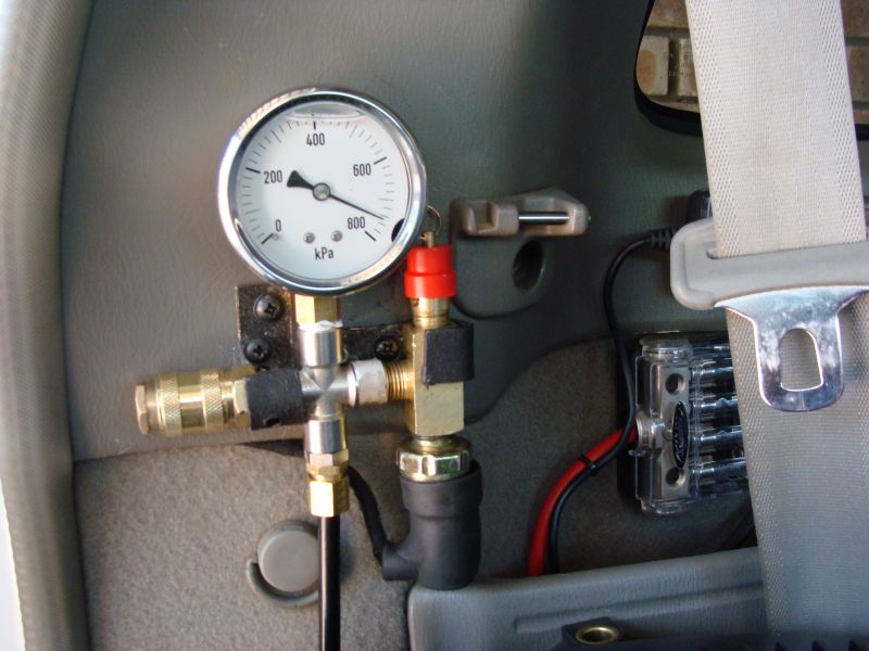

The other pipe leads to the inflator fitting. I discarded most of the original items - a pressure regulator, two crappy dials and a male (doh!) quick-fit connector. In its place I have a better quality gauge tha read up to 800 kPa, a female quick-coupler, the original pressure release valve and the original pressure switch to manage the pump.
Manifold with all the goodies
The pump is activated by a switch on the dashboard (only active with the ignition), which is then fed through the pressure switch and finally used to activate a relay that turns the pump on and off. I used nice thick wiring everywhere, coupled with decent fuses. The wiring & high-pressure hoses are all covered with addditional shrouding and cable tied out of the way as much as possible.

The 8 liter tank takes about 3-4 minutes to get fully pressurised. The pressure switch cuts power to the relay at about 750 kPa, as can be seen in one of the photographs. I deflated one tyre to 1.5 bar and connected the inflator hose. Hmmmm... that was not so easy at all. Next time I'll connect it before pressurising the system! :doh:
Re-inflating the tyre from 150 kPa - 200 kPa took no more than 25 seconds, but dropped the pressure in the tank enough to get the pump started again. By the time I had checked the pressure, added a spurt or two more air, then checked the pressure again, the pump had stopped again - ready for another tyre!
