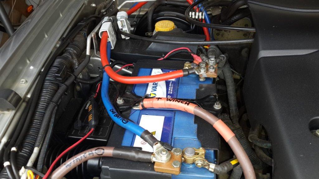

I have now built up what I think is pretty much the perfect dual battery system and winch setup.
Some of my requirements were that I wanted to be able to start the vehicle and run my winch from the second battery (or at least support the main battery when winching), thus I used 50sqmm cable from front to rear. I also wanted to be able to see status of the battery (voltage) without having to connect a volt-meter. I also can see voltage of the main battery at any time, as the TPMS system also has a voltage readout.
For the second battery my ideal solution was a 100ah lead crystal Deltek battery placed inside a National Luna plastic battery (fits perfectly).

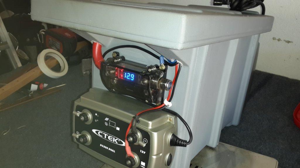

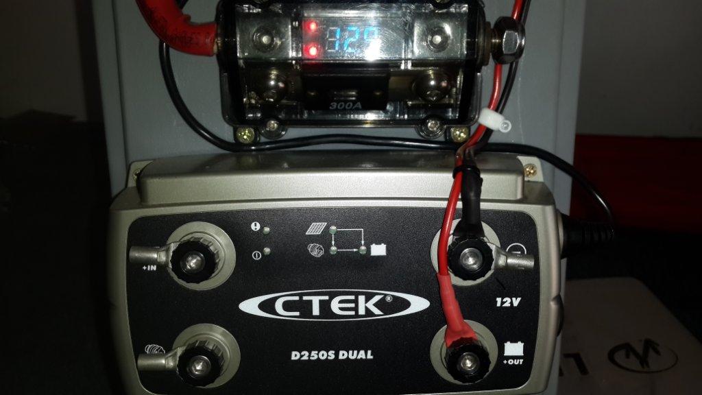

I have placed an in line high amp fuse which I bought on ebay - this very neat unit also has a digital voltage readout which I connected via a small switch, so that the voltage read out does not work continuously and drain the battery when I leave the system on the shelf for long periods. At any time I can just flick the switch and see the volts.

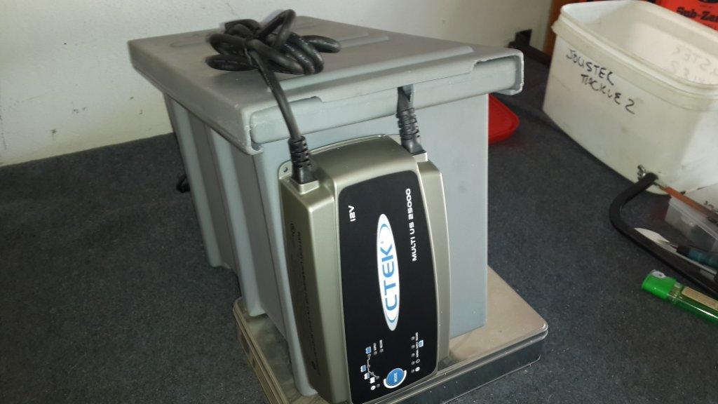

I have selected to have a Ctek D250 DC-DC charger that can take input from the alternator or a solar panel, and can charge at 15amps. I have also decided to use a Ctek 25000 (25amp) AC-DC charger for when I have the opportunity to do a quick charge via mains electricity. I can connect these chargers to charge both batteries simultaneously or individually.

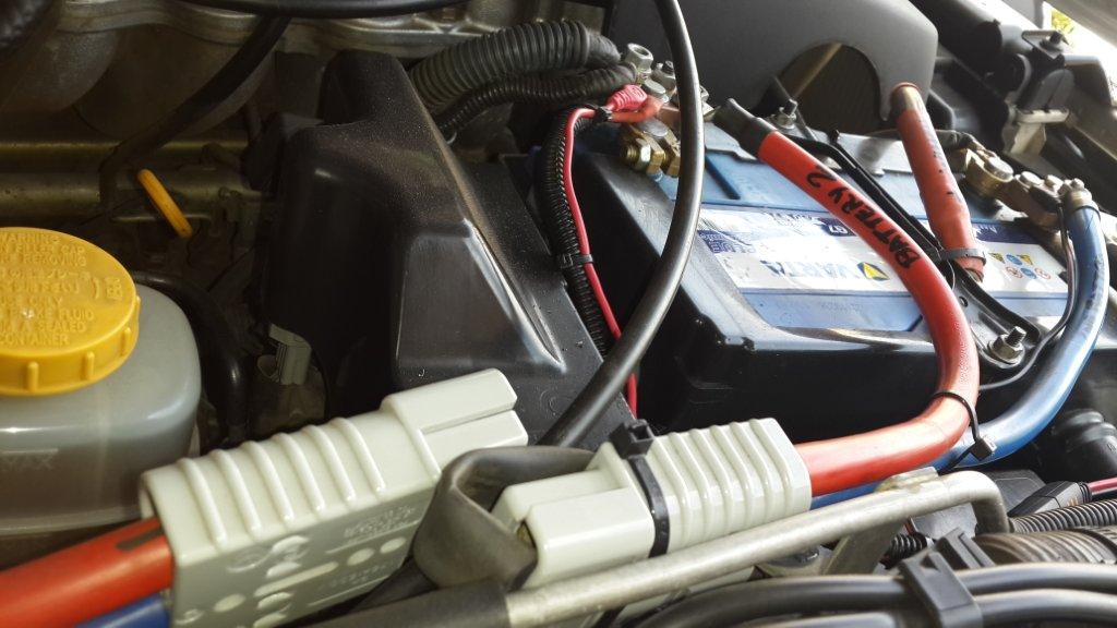

I can isolate the two batteries either at the rear battery or the main battery by means of a suitable large Brad Harrison connector.
I laid the cables under the vehicle along the chassis longitudinal strut and drilled two holes on the floor to pass the cables through to the cab at the back. I used two suitable grommets to seal the area where the cables pass through the bodywork.
As I bought all the main components onteh internet (amazon and ebay) The whole set-up cost a fraction of what it wouldbeauty of this whole set-up
The only thing still to do is decide what, and how many plug points to fit on the battery box for the various accessories like fridge, etc. Maybe someone can advise??
I also made some very heavy duty battery terminal attachments for connecting the winch and the thick 50mm cables that run to the back. I also upgraded all the winch cables to 75mm – this has made a massive difference in my winching power – in my view one of the main reasons why winch does not perform adequately is due to voltage drop over the cables which result in loss of power and even burnt out motors. I also fitted a wireless winch control and new generation winch winch solenoid box (1/5th size of old Warn box).
I also replaced the warn M8000 motor with the 6hp motor that fits on the 9500 winch, effectively making my winch a 13000lb winch due to the gearing – the end result is awesome difference – with 2 batteries connected and more powerful motor on the winch so I no longer need to hassle with the snatch-block when winching the boat..
As I bought all the main components described above on the internet (amazon and ebay), the whole set-up cost a fraction (1/3) of what it would have cost if trying to source locally in ZA - I am very fortunate that I also do not have the high shipping costs as I collect directly in the USA either via colleagues or myself travelling.

Nice one man ......I would suggest you use a brad harrison for your frige to connect to battery the others rattle loose
