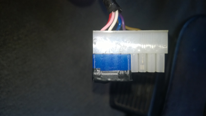

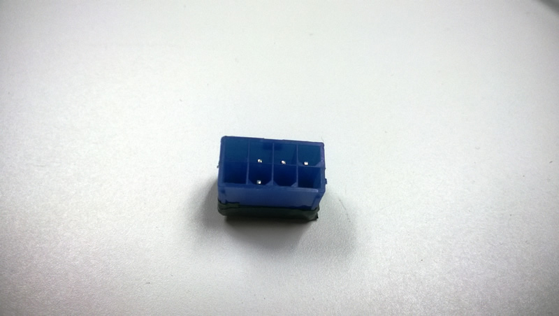

Basically I recently replaced fuel pump and filter as well as air filter on my 4.5 Patrol which made a noticeable difference in power delivery except for a tiny but noticable slump between 2k and 2.5k RPM, and fuel consumption was still 4.5 and worse. With all the changes I decided to send the car in for a remap. The remap gave me not as much as a single kw in extra power but it did resolve the little slump. I have been a little doubtful of the chip's influence on the car's general performance from a performance and fuel consumption point of view. I asked KSD if they can provide me with a bridge plug as I would like to just compare the with and without. Unfortunately they did not have and advised me that it would be very hard to still find bridge connectors for these old chips. They did however give me the wiring diagram and indicated the wires which were to be bridged. I have attached the diagram for your perusal. Bridge points 13-14 and 7-15. I just tested it with 2 paperclips which worked. I now made my own little bridge connector as the paperclips did not leave me with a warm and fuzzy feeling.
From a driving point of view I have to admit it is very hard to feel any differance in power delivery with or without. I will do a fuel consumption comparison this weekend and revert back.
