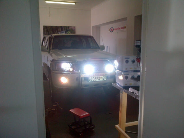

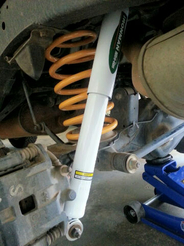

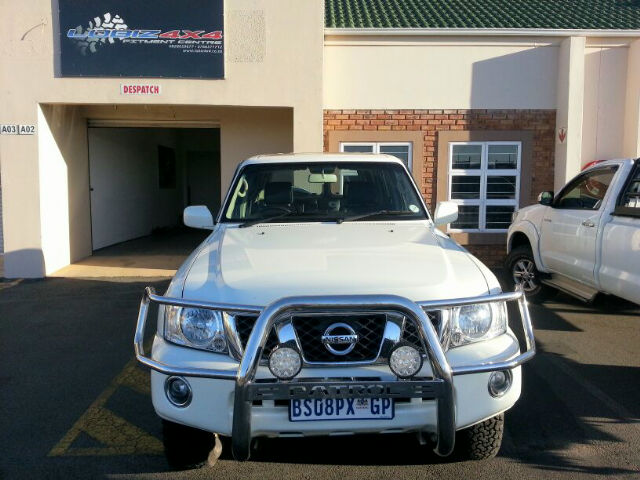

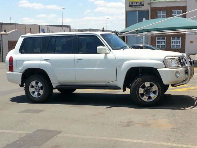

Hi All
Done Ironman performance Suspension on Venter Patrol 4.8 GRX 2006 model, nicely 50 mm lift :biggrin:, Also done the front Disc and brakes what a mission to find the discs
( 315.5 daim 47mm Height and spigot size 109.6) but i manage to get @ R1870 per disc,"Powerbrake in PTA don't have stock and the retail price is R7800-00 for a kit" :surprised: . also service the front Wheel bearing while everything was stripped already and i found some water inside the hubs, Also fitted 2 led spots 3600 lm per light, manage to fix existing wireing harnes with relays and in line Fuse
:thumbup: Venter with the support
