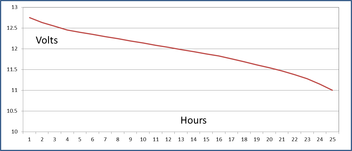

After researching long and hard I bought myself a 100AH Lead Crystal Battery - actually wanted a 120AH but got this one at a real bargain price. What I have read on the internet and seen actual trials on YouTube seems almost too good to be true, so when I got the battery home I put it to the test. I made sure it was fully charged then I connected it to a 60 watt globe to see how long it would take to get to a state of 11volts under the said load of 5amps.
The result is astounding, see the graph below. A normal lead acid will not achieve this, and if you did push it for the same duration you would do permanent damage to the battery. The beauty of LeadCrystal is that it can be taken to a completely 'flat' state and recharged without any damage - it can cycle like this hundreds of times according to its specs.
Back to the graph - this shows that the battery pumped out over 100AH over the 25 hours, where you can only get around 60-70% of the AH out of a lead acid, and maybe 80% from a deepcycle without risking damage.
Speaks for itself in my view - the LC is more expensive but will last you 5 times the life with far better performance - output, quicker recharge etc....
Do yourself a favour and research this ... you wont buy another battery!

- Picture2.png (16 KiB) Viewed 6449 times
