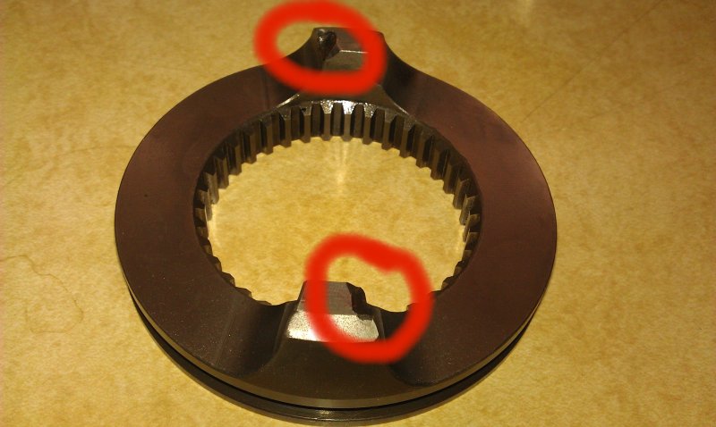

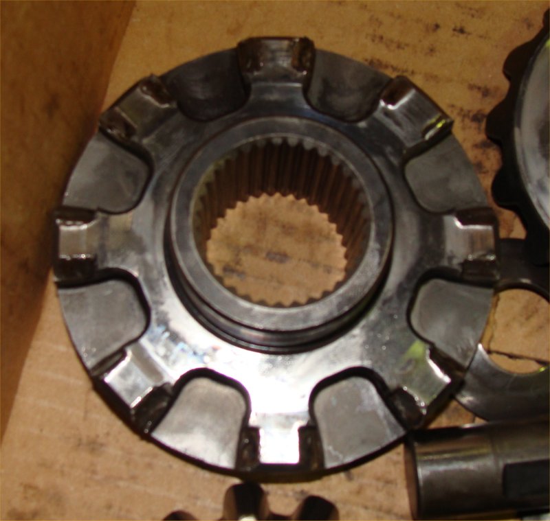

Post by ChristoSlang »
Peter Connan wrote:If there is a problem, the chances are 85% that it is a vacuum problem. This is relatively easy to sort out. Some guys strip and overhaul the solenoid, some replace them with far more robust industrial solenoids. Just don't ask Nissan to fix it for you.
Most of the last 15% is that the electrical switch on the rear diff that tells the system when engagement has occurred is faulty.
And if you do not fix it quickly, you'll end up with worn bits & pieces resulting in a HUGE repair bill...
Been there, ran away from that :rolleyes:
Yoh! Maar dis lelik!
