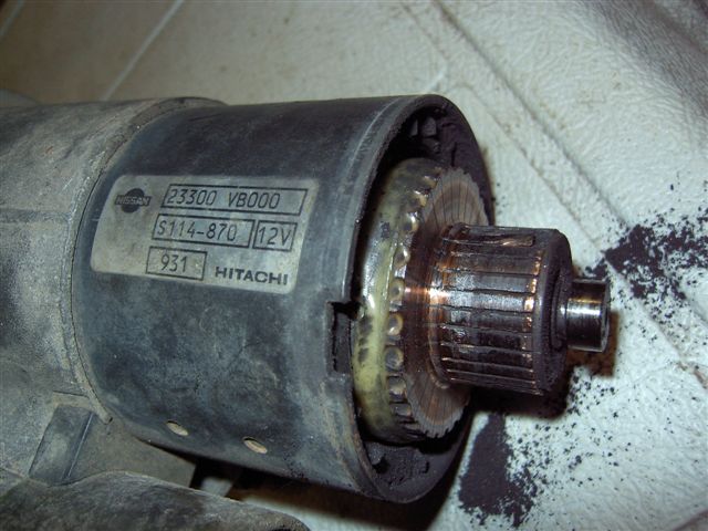

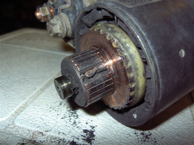

Ungili se knormoer (starter) is in sy M@#R.
One of the segments of the comutator broke off and another one is bent. I will have to replace the starter!
- Starter-EPSN3017.JPG (62.04 KiB) Viewed 2823 times
- Starter-EPSN3015.JPG (57.5 KiB) Viewed 2823 times

And so my starter said good bye and good night....
Yesterday with the Patrol fully loaded with everyone to go out for the day, it just would not start, only made the clicking noise when i wanted to start it.
So got out the old voltmeter, battery ok,power on to solenoid of starter, ok.
So, off came the starter and voila, it was broken, look exactly like the posted pics. The copper stripps all ripped to pieces. So there went the whole sunday trip.
