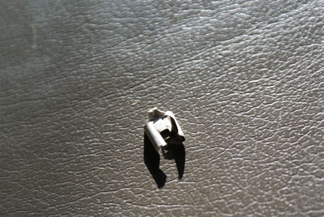

Re: Petrol Boiling in extreme heat conditions
Even before changing the petrol filter, you must open the cap to release the pressure in the tank!
When we where on the Botswana Outreach and had the fuel pump connector problem - before I found the problem, I changed the filter and because I did not open the cap, the fuel burst out the pipe and burned my arm! I thought afterwards the petrol was so hot because of the connector problem that burned of halve the connector away.
