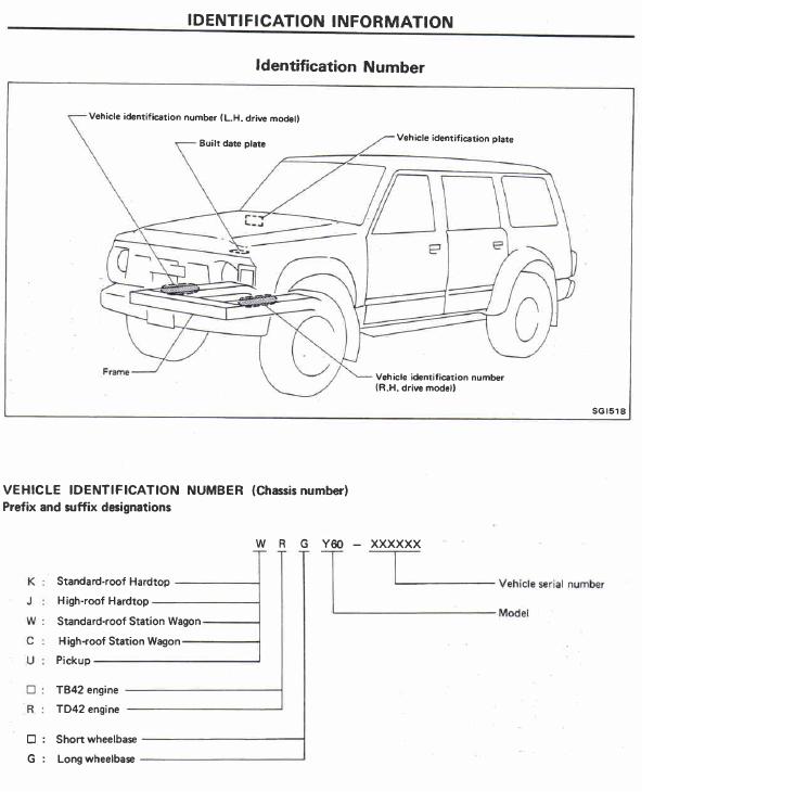

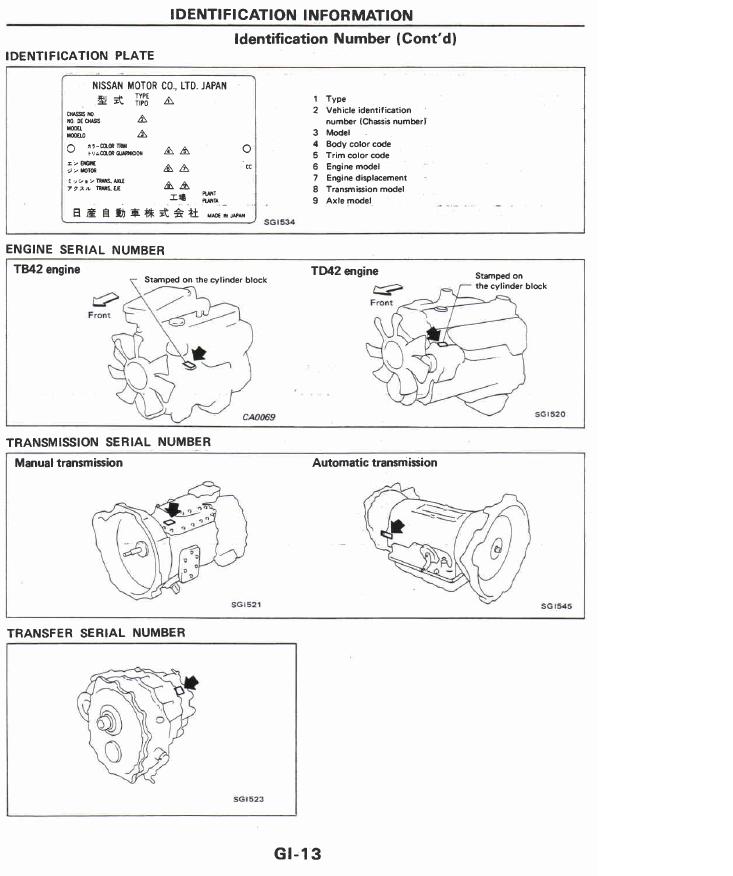

Chassis Number Location on GQ
Post by PatrolNW »
Does anyone know where the location of the chassis number on the GQ is?
Thank you
Re: Chassis Number Location on GQ
Check this out ... hope it helps
identity plate GQ.JPG (50.46 KiB) Viewed 3230 times
identity plate GQ a.JPG (69.63 KiB) Viewed 3229 times
