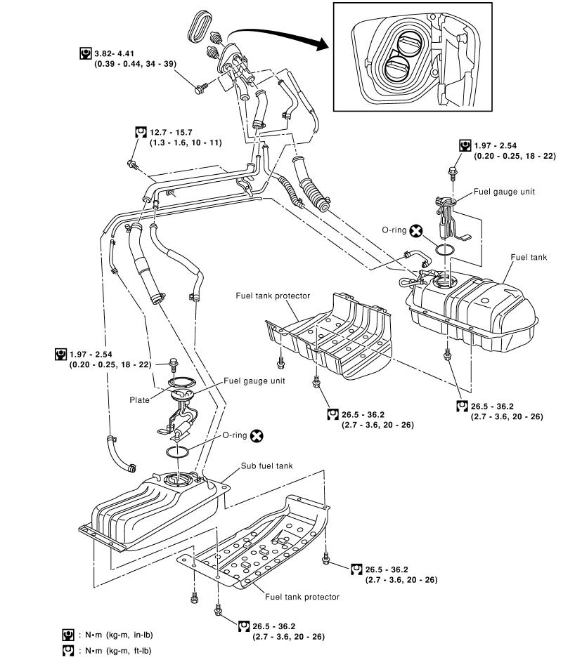

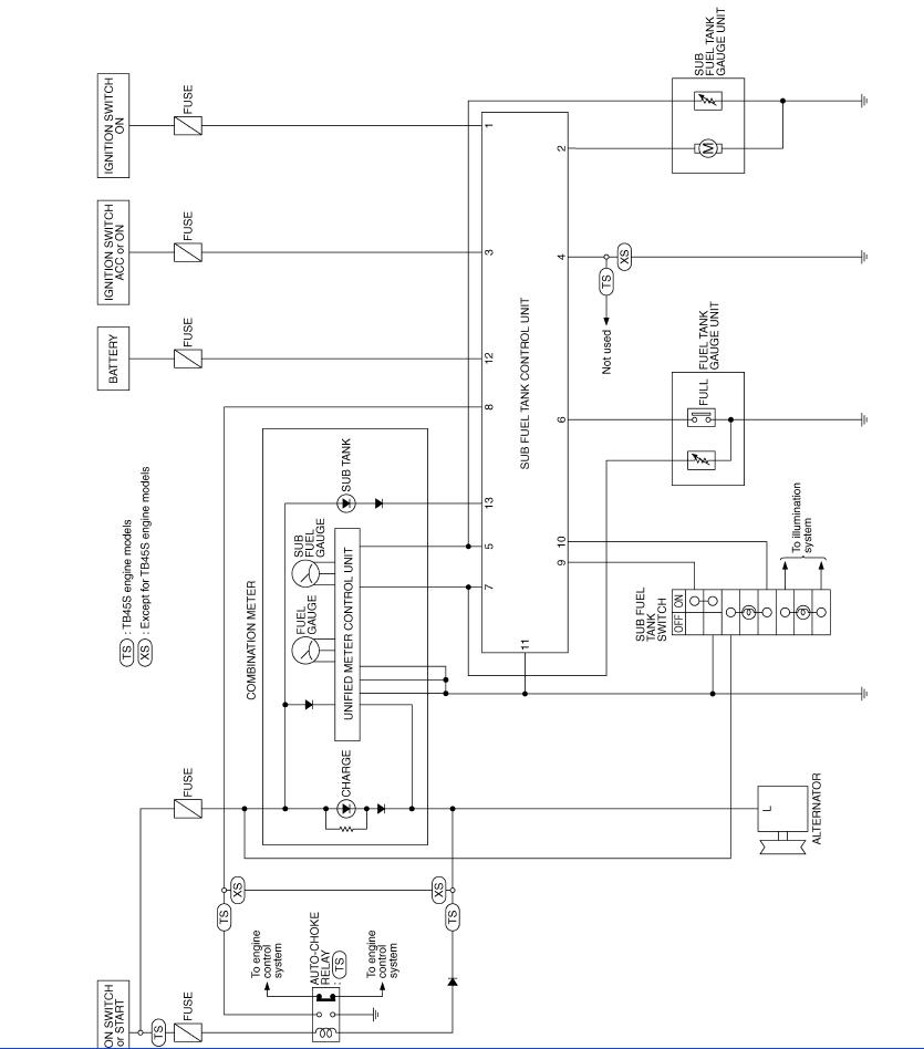

My sub tank fuel automatically run into my main tank without me switching the valve/pump on at the switch . Do anyone know were do I find this pump or valve to check that went faulty because it used to work correct previously .
Re: Sub Tank Pump/valve
Contact Herrie op Safari [Kobus] for the Workshop Manual of th ePatrol .. that should show you what's up...

Looks like it is inside the subtank... :think:
Post by Christo Grobler »
Thank you all for the feedback i will start tracing the fault and let you in on what i found . Groete Christo.

Op my 4.8 het ek nog nooit opgemerk dat die subtenk self uittap na die hoof tenk nie. Ek weet die subtank het n self toets wat 30 sekondes pomp nadat die ignition aangesit is. Ek moet altyd die subtenk laat oor pomp. Gelukkig pomp hy darem vinniger as wat die 4.8 dit kan gebruik.

Oom Mac die naald staan nou weer stil ekt gelees van die fault code reset in manual dis iets kleins wat rondneuk . Van watter Prado praat Oom Mac nou het ons dan ge-convert na Toyota !!! :salute:
