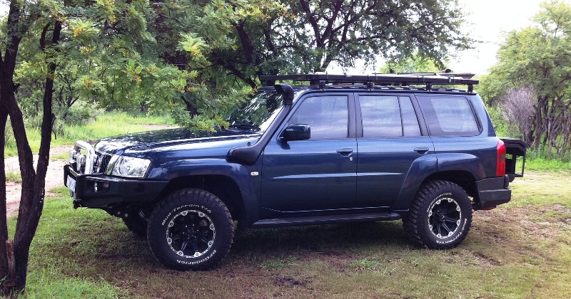

Hi Dawid, I have 305x70x17 BFG mud terrains on my 2010 GRX, these are 34" and fit without any rubbing or problems even when going hard to "port or starbooard" :biggrin:

Not noticed any change in power... still plenty there! Speedo remains accurate when compated to GPS.
My Trol has a full Old Man Emu suspension kit and lift... not sure of exact mm lift as I took possision of the car with suspension changed from stock to OME.
