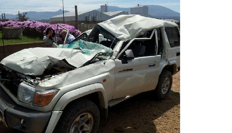

Scary photo, hence the topic
This is what happened to a good friend of mine on the Stilbaai / Vermaaklikheid dirt road about 10 days ago.
His back fractrued but no permanent damage. Kids were fine, miraculously.

For a moment I was afraid it depicted a Patrol.
Than the Lord they were alive.

Alex, I am glad your buddy and his family survived.
there are obviously a large number of factors influencing a vehicle's performance in a swerve test.
I would tend to group them into two cetegories. The first can be named "rollover angle" and includes all the factors that determine a vehicle's rollover angle in a static position, mostly being the track width and centre of gravity height, but also influenced by suspension stiffness, tire sidewall height and pressure and a number of other small factors.
These are fairly obvious, and we must always remember that these are 4x4's and not sports cars.
The other less obvious category could perhaps be named "directional stability", but what is really important here is how easily a vehicle will oversteer.
I believe that a great majority of rollover incedents have more to do with this factor than with the vehicle's ultimate centre of gravity or "rollover angle" as described above. Because when a vehicle is oversteering and hits any obstacle with a tire sidewall, it will turn over much more easily. I have even seen a very wide and low sports car rolling after sliding into a curb.
I firmly believe this is the factor mostly influencing the Frotuner's reputation, as several people have remarked to me that these things are virtually uncontrollable on a wet road. I suspect the full-time 4wd with torsen LSD in the centre diff affects this, but wheelbase is also a significant factor here, and this vehicle has a relatively short wheelbase.
Your friend's cruiser also has (had?) a significantly shorter wheelbase than the Patrol.
Other factors influencing this are suspension stiffness (here stiffer rear suspension and particularly badly matched shocks can be detrimental), tire flexibilty and sidewall height etc.
Fortunately you have to severly taunt a Patrol to get it to oversteer, but I am sure a good advanced driver's course can significantly improve your safety in this situation.

Re: The Swerve test and homologation
Excellent post, PeterC
I agree that the Y60/Y61 Patrols actually have very benign handling for such monstrous vehicles. The long wheelbase does help here.
The 76 Series Cruiser in the picture above has a wheel base of 2730 mm compared to the Patrol's 2970 mm (Patrol's wheelbase is about 9% longer).
I doubt whether we will ever know exactly what the root cause was of the early Tunas' propensity for misbehaving, but I doubt whether the Torsen center diff is the culprit (this issue also affected the 4x2 versions). My pet theory has revolved around inaccurate rear axle location (due to the fact that the springs are attached tot the trailing arms and not to the axle directly, thus requiring large bushes that limit flex excessively unless they are made quite soft) in combination with tyres with low lateral stiffness and cheap shock absorbers. When the Tuna was updated Toyota changed the tyres (to A/T tyres with stiffer sidewalls and specified lower profile tyres) and added electronic stability control. There are different numbers in the Toyota parts system for the shock absorbers now as well...Peter Connan wrote:I firmly believe this is the factor mostly influencing the Frotuner's reputation, as several people have remarked to me that these things are virtually uncontrollable on a wet road. I suspect the full-time 4wd with torsen LSD in the centre diff affects this, but wheelbase is also a significant factor here, and this vehicle has a relatively short wheelbase.
