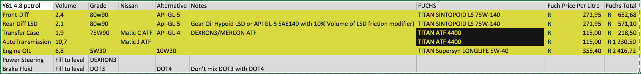

Spoke to Nissan Parow today and they recommend alternative FUCHS lubricants as per attachment. The rate per litre as quoted by FUCHS Cape Town. Im awaiting FUCHS quote from Nissan.

karldDanneberg wrote:Spoke to Nissan Parow today and they recommend alternative FUCHS lubricants as per attachment. The rate per litre as quoted by FUCHS Cape Town. Im awaiting FUCHS quote from Nissan.
R355 per litre for engine oil? what is FUCHS smoking :think: Even Mobil 1 fully synthetic in 5W30 or 0W40 is less than half this price.
