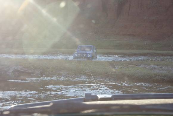

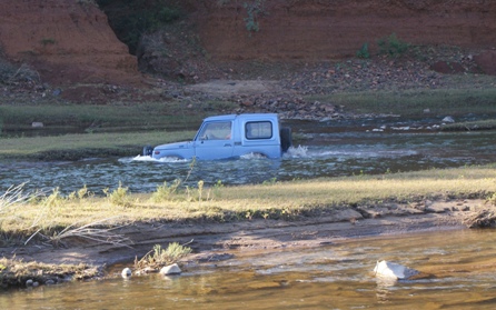

Here is Susan - Afrikaans - on her way to get rid of the transfer case.
Patrol did very well. But that F(%#(%#(G winch died on me, and I think blew up my battery!!! :cussing:
