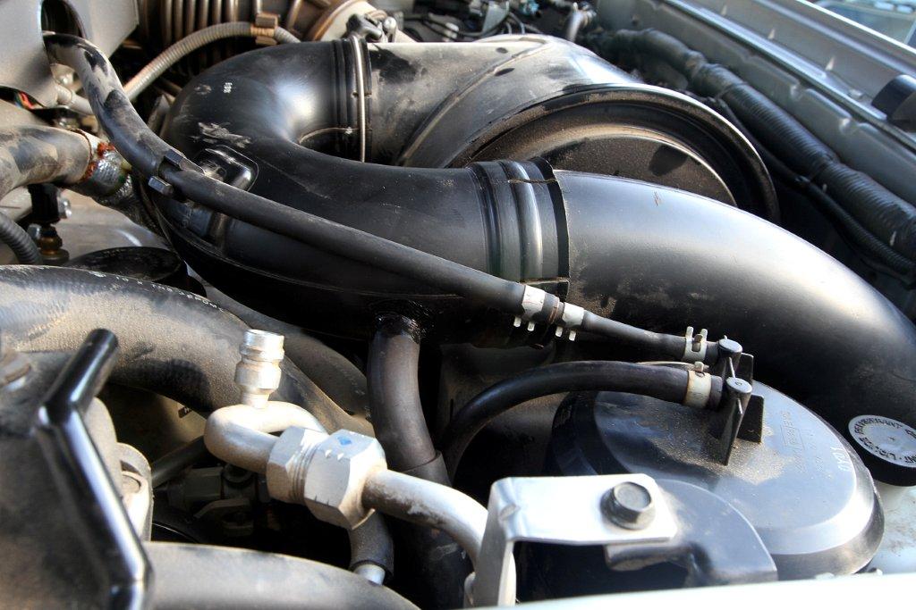

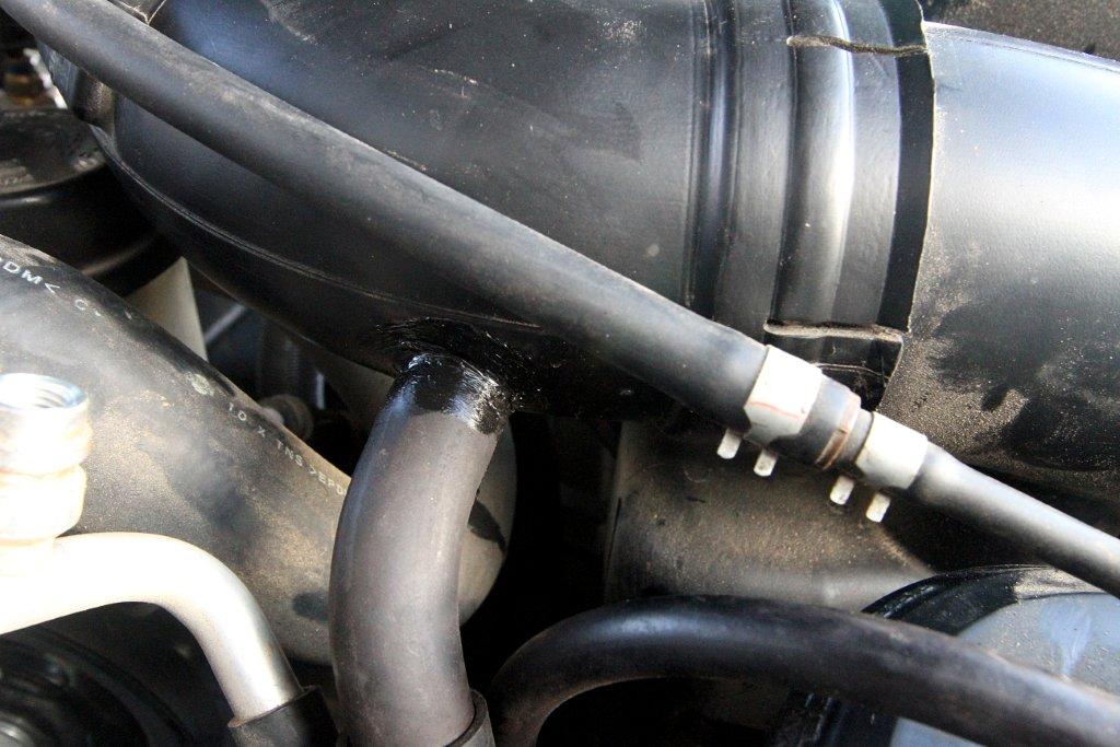

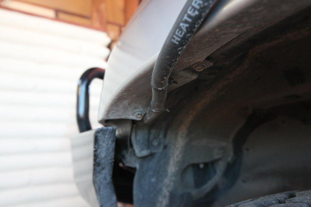

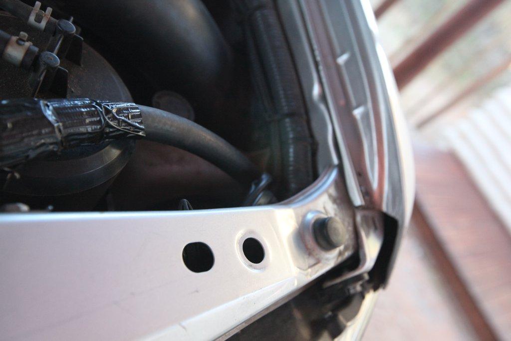

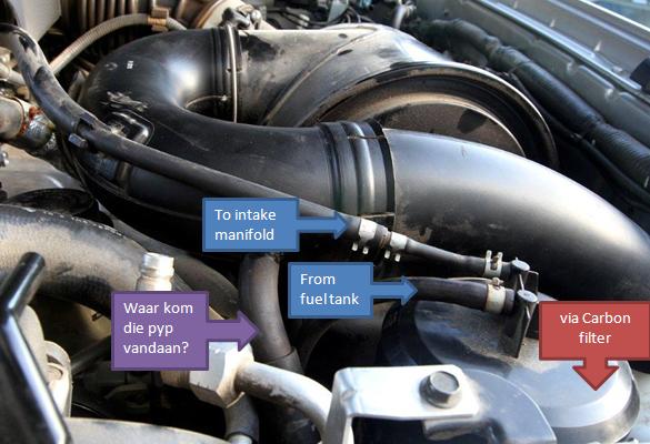

Op die standaard Patrol kom die breather pyp (uitlaat/valve) aan die kant vd engine bay by die wheelarch uit, naby waar die air intake is - maw die petroldampe word weer "ingesuig" by die lugfilter - met die opsit van die snorkel word die oorspronklike air intake afgeblok (omdat dit nou bo by die cab is) van die breather pyp en het die petroldampe nerens om heen te gaan nie en vergader onder die wheel arch. DTM Helderberg (Nissan) het 'n klein modifikasie gedoen en die breather/valve pyp direk in die air intake pyp gesit en dit sal hopelik die probleem uitsorteer. :thumbup:
Jammer vir die gemengde taal maar ek weet nie wat al die korrekte Afrikaanse woorde is nie :thumbdown:
Hier is 2 pics van die modifikasie:

I thought that the above would solve my "petrol smelling problem" but when I went up to the Kgalagadi through Namibia in October I found that the mod just exchanged one issue for the next:

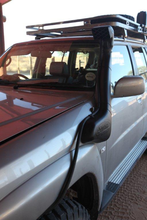

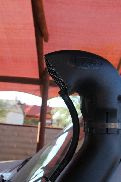

It was quite hot from Springbok onwards (+- 38/39 degrees C) - when I stopped at Aus for a refuel, the Patrol didn't want to restart and after a bit of an inspection and thinking I realised that it was flooded. As the mod put the released petrol fumes into the air intake at that specific point, it had nowhere to go (once you've stopped and switched the motor off) - thereby flooding it via the air intake. I opened up the air filter in order that the "extra" fumes could escape and whalla .... it started. From there we drove to Canon Lodge where we spend the night and as it was cooler the next morning - no problem it started easily. From there we drove to Keetmans (again very hot) and the same problem arose when filling up there. I got the idea to lengthen the outlet to the snorkel intake as this would boil down to the excess fumes taken in while driving, with the release of the fumes into the air when standing still. It was quite a mission to source a suitable hose for such an extension, but I eventually got a 3m piece from an electrical supplier. As time was a problem we drove on to Mata Mata where the same flooded problem made me open the air filter again to be able to start the Patrol. When we arrived at Kalahari Tented Camp I made the "alteration" to the mod and from there on I didn't encountered any further problems even though it was still very hot, and everybody that's been to the Kgalagadi knows the corrugation can stir your fuel even more - to add injury to such a problem. Following is some pics of the bush mechanic jobbie.

Die pyp "waar kom die pyp vandaan?" is die breather pyp wat die ekstra gasse wat die carbon filter nie kan hanteer nie tot onder die wheel arch naby die air intake op die standaard Patrol vat. Deurdat die intake met die snorkel nou doer bo in die lug sit het die dampe opgehoop in die wheel arch (wat normaalweg ingesuig sou word deur die air intake) en vandaar het Nissan die breather pyp geskuif om direk in die air intake te gaan. Die posisie daarvan het egter veroorsaak dat hy flood sodra jy stop en afskakel. Met die verlenging wat ek nou gedoen het simuleer dit eintlik presies die standaard Patrol se setup.
Indien ek dit reg het is die doel vd carbon filter om die petrol gasse wat opbou in die tenk te onderskep en te hersirkuleer na die "intake". Die doel vd breather pyp ("waar kom hierdie pyp vandaan?") is om dit wat die carbon filter nie kan hanteer nie uit te laat in die atmosfeer. Maar omdat die uitlaat naby die air intake sit (op die standaard Patrol) word dit deur die air intake ingesuig wanneer jy ry. Dit is net wanneer jy stop/afskakel dat die gasse eintlik in die atmosfeer vrygelaat word. Met enige ander setup sien mens nie die hoeveelheid dampe nie maar dit lyk na nogal baie petrol wat so verdamp as jy hom met die oog check :surprised: :lol:
