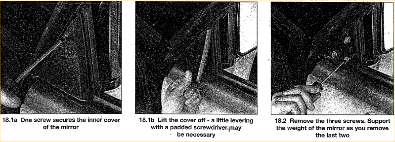

Cedric, it may be even simpler!
1. According to the manual, you only have to remove a single screw that holds the inner cover in place, then prise off the mirror cover (a padded screwdriver is suggested).
2. You'll find three screws behind that - undo them while supporting the mirror from the outside.
3. Disconnect the elecrical connector (if fitted).
Hier's 'n kiekie wat alles mooi wys:

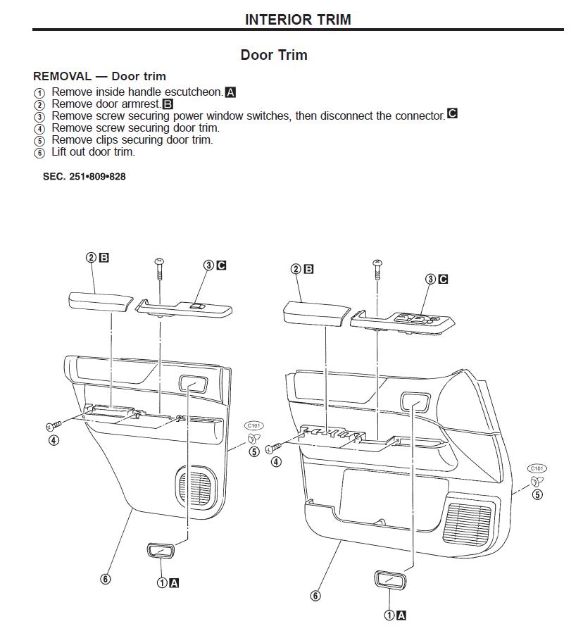

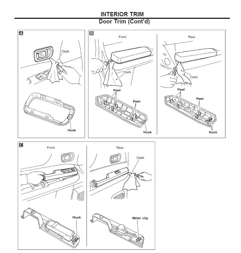

Re: Door panel removal
Here is the instructions from the ESM...

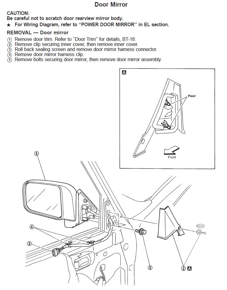

... and for the mirror...
Hope it helps
Hope it helps
