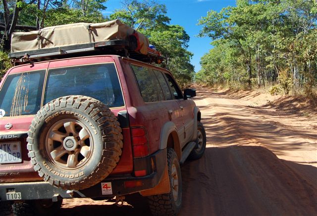

I really struggled to get proper mudflaps for the Patrol and in the end bought a rear set in Malaysia.
I think it is very easy to make, as described by Babelaas.
I used poprivets to attached mine to the rear bumper and it works fine.
I think mine is currently a bit short, but I can just move it down a bit.
I will take a closer photo and post it.

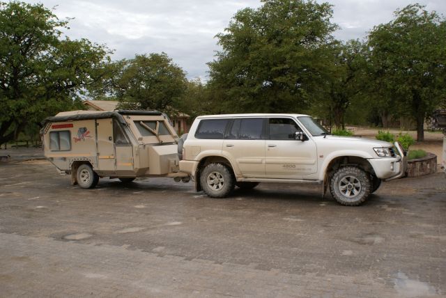

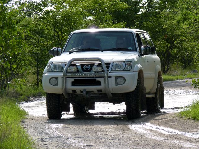

I made long mudflaps with 5 or 6mm rubber sheets to use for a trip to Namibia. They were 400mm wide and 500mm long.
I attached them by using the lower 3 screwholes in the fender. I used longer bolts with big washers on the fenders and the inside of the I attached with cable ties (at the rear left side I used a hole close to the exhaust hanger and on the right side I put cable ties around the chassis and attached it to the flap with more cable ties, in the front I attached the cable ties to the stabilizer bolts). I didn't have chains on it but fortunately I didn't reverse in thick sand which could have caused problems. We drove 7000km and didn't have any problems with the flaps.
These are the best photos I have of the flaps, unfortunately you can't see the bolts, washers and cable ties on the photos.
