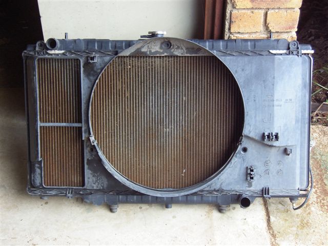

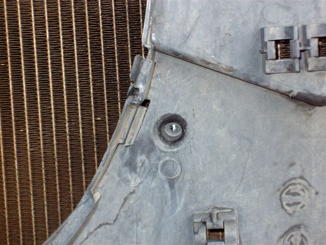

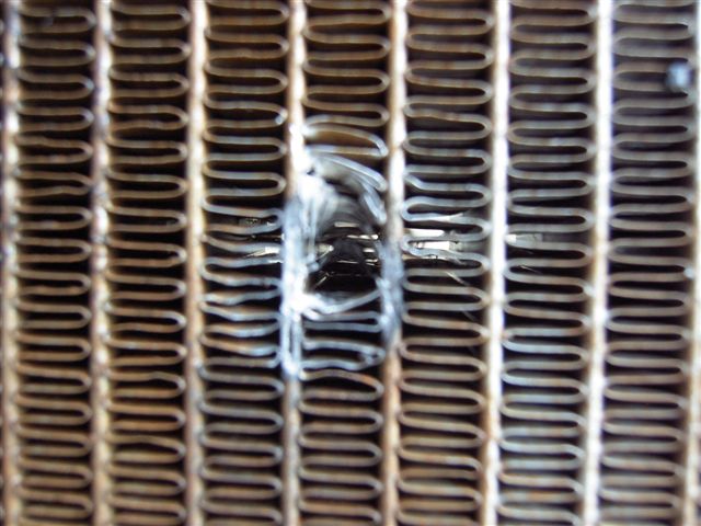

The problem I had on my Patrol was that the cover on the radiator - on the inside - have 2 pins at the bottom and 2 screws on the top that secure the cover.
One of the pins at the bottom broke off and the cover started vibrating. There are two plastic studs on the inside of the cover that was touching/hitting the radiator becauce of the vibration.
I fixed the hole with Pratley Steel and curry powder and it was fine for months till I hit the cow in Botswana and had rhe radiator replaced.
This is where the stud/pillar hit the radiator

This is the stud/pillar that touched the radiator normally
Radiator 1.JPG (67.29 KiB) Viewed 2261 times

I can't see the hole but can feel it. when looking at the your photo of the hole up close, and when I feel with my finger on my radiator.... this could be what caused the leak !!!.... I'll keep you posted when the radiator is out !!
