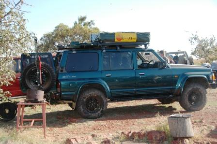

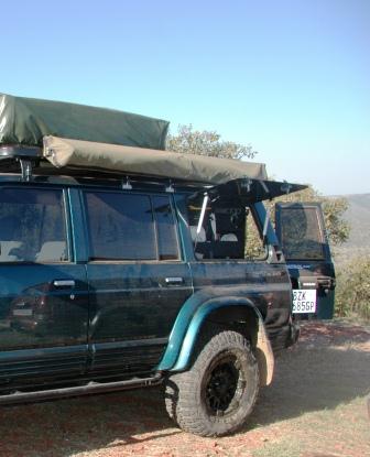

I opted for steel wings so I could weld the hinges on. With Aluminium, you would have to bolt them on. I also opted for a gloss powder cote so they would resemble the rear windows.
Wing Closed.jpg (64.46 KiB) Viewed 10578 times
Window Open.jpg (58.35 KiB) Viewed 10578 times
