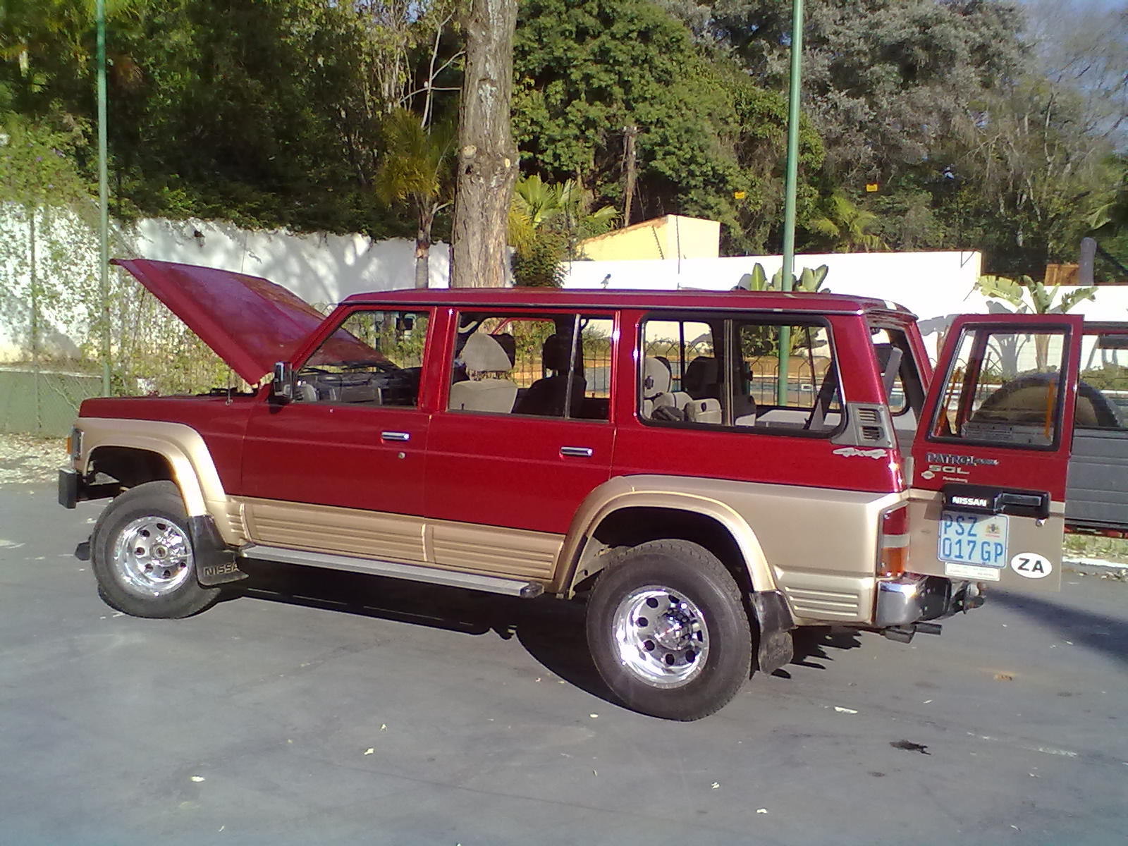

After four years of driving Discovery, I discovered Patrol. I bought this lovely, no, menacing looking beast two weeks ago and now I want to learn all I need and can about it.

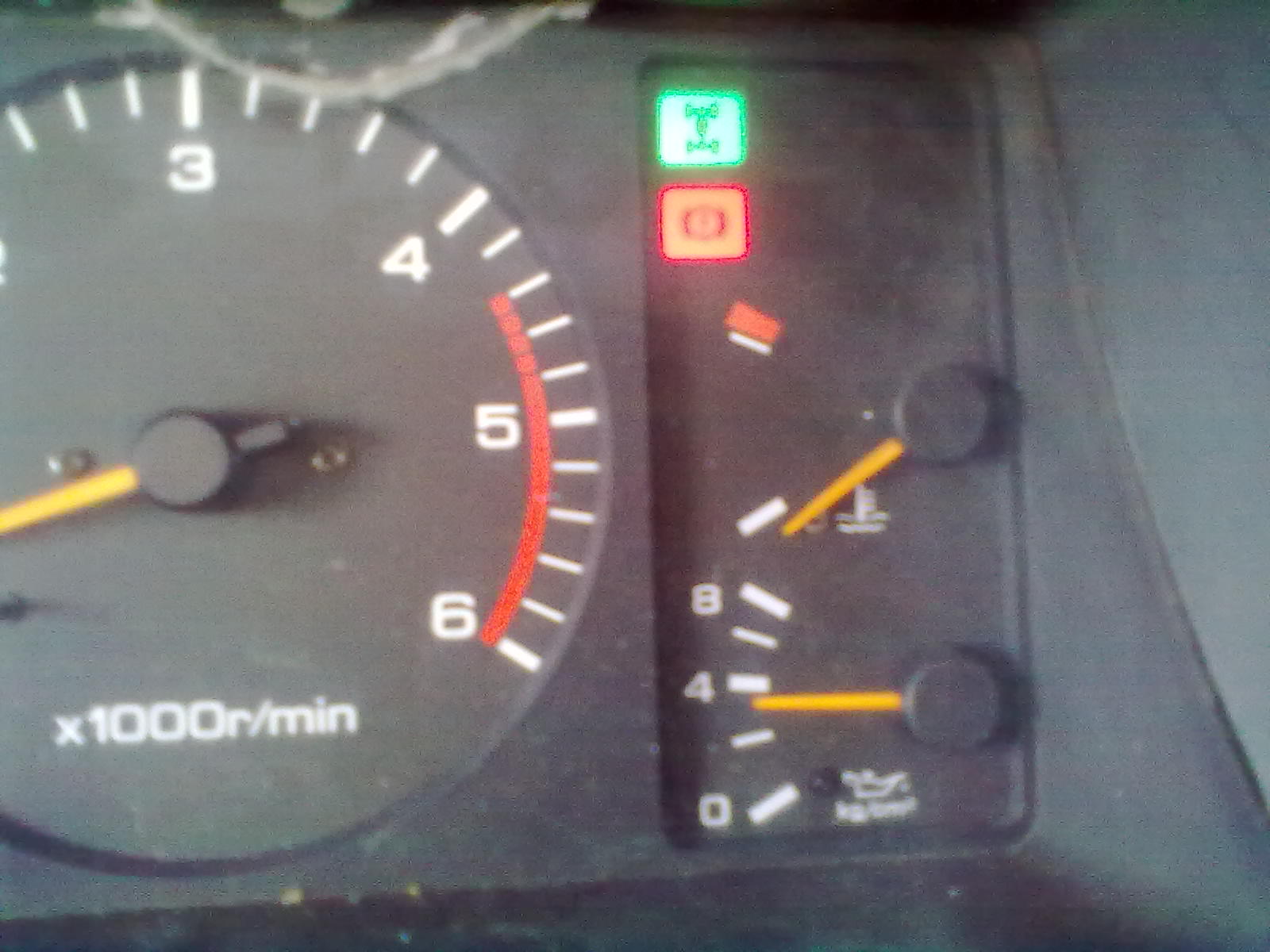

I figured out that I have to get out of the car to engage(lock) the front hubs when I want to go into 4x4. I cannot however figure out if the difflock engages when I turn the small switch which says 'Diff Lock'. I do not hear any clank-thud or grrrr, and there is no warning light on the display-board to indicate that it has engaged. How does it work and what should I look for if it does not work?

It looks as if the rear-end is hanging a bit although the shocks and coils seem to be in good condition. Any suggestions on suspension 'upgrades' etc.?

There should be a light which comes on when the difflock is engaged. No light may only mean that the bulb has burnt out.
Usually, Patrols sit higher in the rear than the front. Your springs may be worn or non-standard. Whether you want to fit a lift-kit or not is up to you, but a fresh set of springs should restore your ride height.

That switch should switch on the diff lock, but you will not hear anything. There is a light in the instrument binnacle, top left that will come on when the diff lock has actually engaged. To make it engage you may have to drive around a corner. It is a vacuum system and will only engage if the engine is running and there is a differential speed between the two rear wheels unless the dog teeth happen to line up. Please note that on these old patrols the diff lock wil switch on or off in any gear and drive mode (you can switch it on in 2H).

These cars are known to sag a bit, but yours looks higher than standard to me. If you are planning an overlander, I would recommend fitting air helper springs in the back, as they can easily be pumped up to conform to any load. Further I would recommend connecting the two air helpers together but with a valve in the pipe so that they can be isolated. I would use 12mm pipe for this. In this way you can isolate the helpers on the road which will give you added stability, but off-road they can be connected to give you uncompromised articulation.

You will have to check your vacuum lines and see if your solenoid is still working properly.

There is a green light that lights up on the instrument panel when I engage 4H or 4L. I accepted that as indication that 4x4 is engaged. This happens whether the diflock switch is on or off. There is no other light. What should the light look like? Does it have a picture like 4 wheels and a cross in the rear diff area?
4x4 light patrol.jpg (165.92 KiB) Viewed 3297 times
Re: Tell me everything about my Patrol
Watter liggie is onder daai groene?
