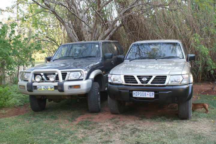

Hi Guys ,
Please check facebook I have tried twice now the Pics does not upload nor does the face book link.
Jeanne Volschenk , Swaziland, The only one.
She's the small blond on the right.
cheers

There you go, Jean:
Tell us more. What did you have to do to get it on the road again?

The biggest dammage was the Front Diff which was bend, This I replace temp with the extra front diff from the 4,2 diesel bakkie. According to Aus website the same ratio's as the 4,5. Nissan veiw this information as classified and although they promise to confirm this for me, I am still waiting. The right door and fender was from the bakkie . I had to replace all the lamps however the only one that was dammaged in the accident was the right main beams the others were all vadalised after the accident. The right rim & tyre was buggered so I bought two new Michellins for the front and put left front on spare although all tyres are still very good. Its got OME shock fairly new,the vehicle was very well looked after. Only outstanding items are the steering wheel airbag that pop and the overfender on the right.
