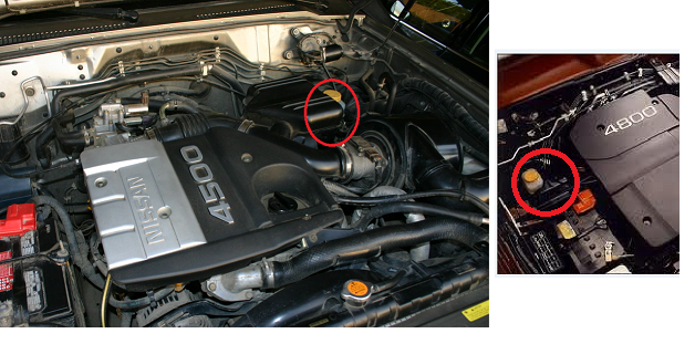

Re: SWARTBERGPAS 1 CLUTCH 0
Is this true?
Is the brake fluid reservoir on the exhaust side for the 4.5?
My old Safari 2.8 and the new 4.8 have the master cylinder directly in front of the driver (intake side) which is much cooler. If this is the case I would really expect some heat issues!
- tour de frans
- Posts: 797
- Joined: 03 May 2009 19:48
- Been thanked: 22 times
The problem if I could call it one,is not on top,its at the bottom,were the exhaust front pipe run pass the slave cylinder.
