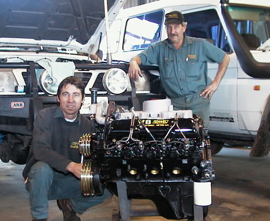

I would consider a GM V 8 diesel.

Grant wrote:I would consider a GM V 8 diesel.
This looks wicked!! Do they supply these locally and what do they cost? Will this fit on the std 3.0D box?

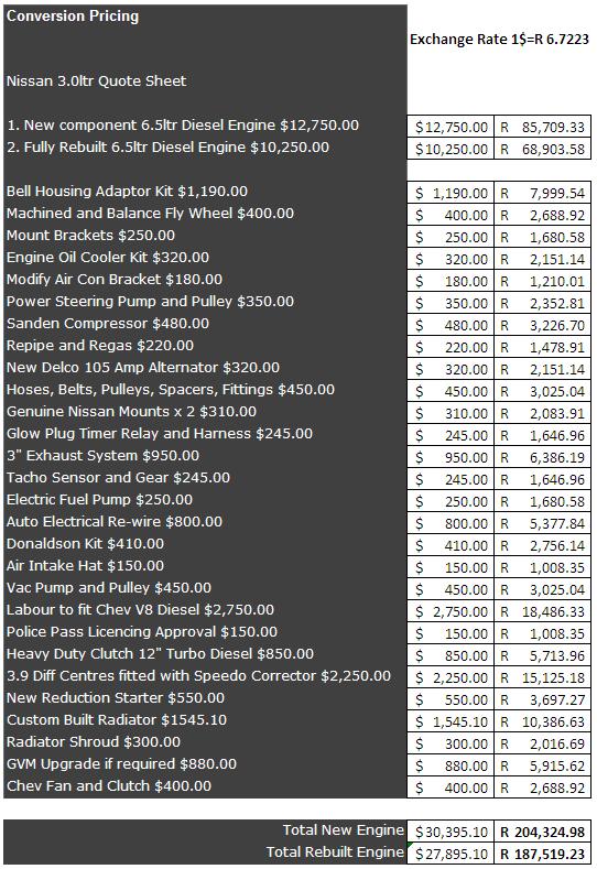

Ouch! Thats R200 000 without import duties and transfer cost :surprised:

David wrote:Ouch! Thats R200 000 without import duties and transfer cost
No David...that's the price of another PATROL! :rolling: Knew there was a reason why that V8 Diesel looked so good and all you could see on that Ozzie oke's face was just teeth because he knew how much dollars were coming his way. :biggrin: Thanks for checking this out for me...definitely back to the drawing board for me, at least I have time. :thumbup: To avoid these nasty shocks will definitely keep my eye out locally...we have a lot of nice machines locally that can fit in that big hole in the front.
My requirements are simple and like most guys...looking for more power than the 3.0D (they are generally sh%t slow and I tow a lot, not to mention I would like to overtake again @ 120km/h and up), reasonable consumption under normal driving conditions (when messing around I am willing to be penalised with heavy consumption), reasonably priced and reliable conversion and engine(once money is thrown at this I don't want to go back every 2nd week) and lastly I want to hear the damn thing roar! Taxi's must know I am on my way! :woo: Is that too much to ask? I think that this is exactly what ALANVS is busy doing with his but I need to get a reasonably similar effect for much cheaper. :think:
