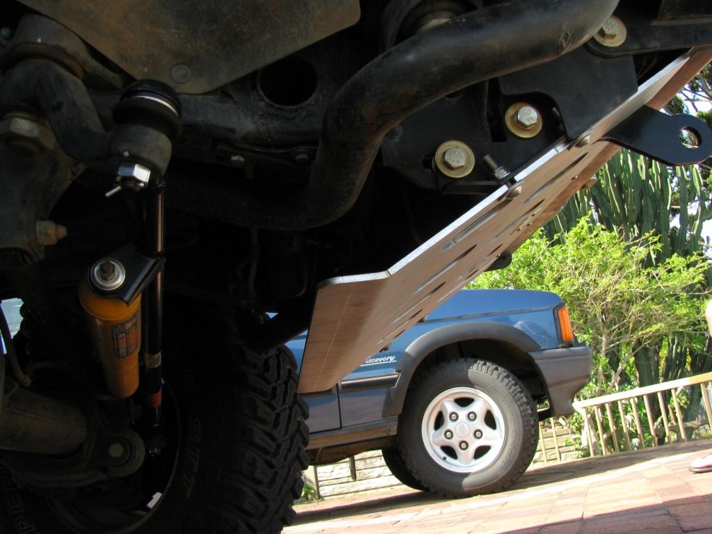

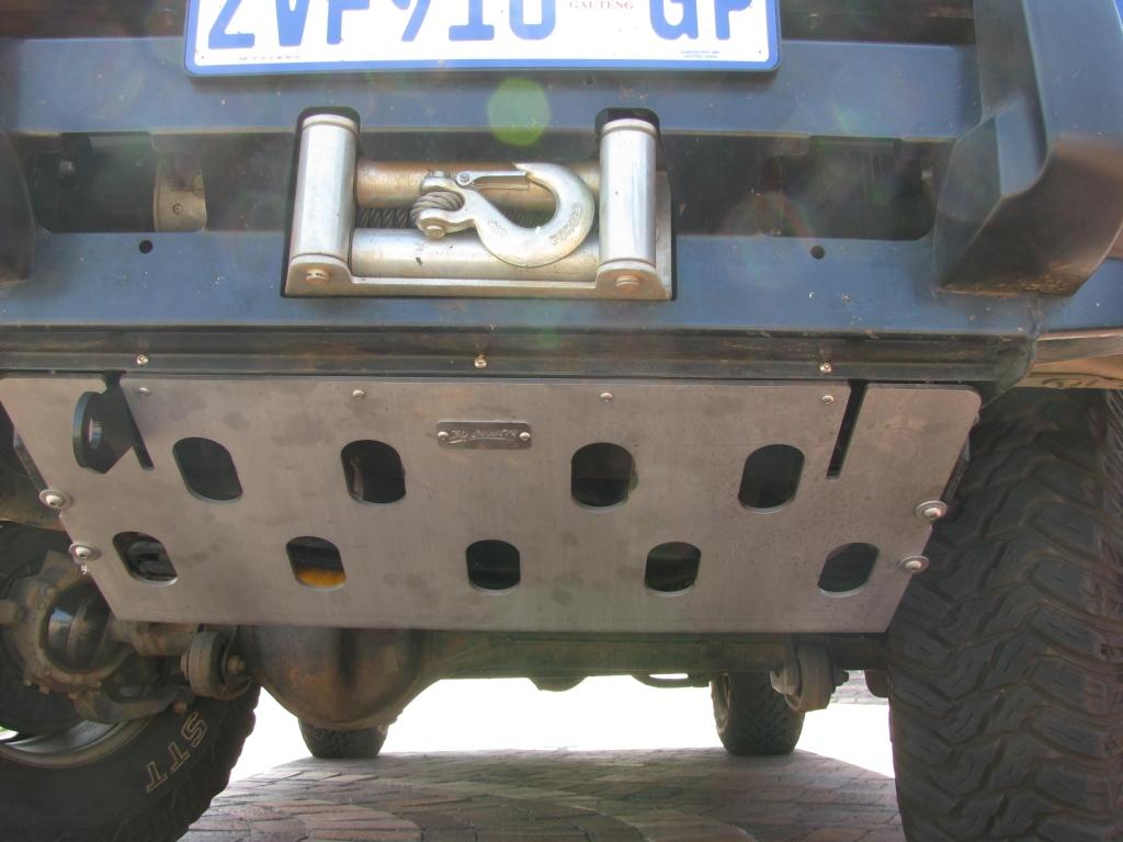

Before the trip to moz, i took the Trol to Richard at Big Country for a roof rack and a bash plate.
Very happy with the bash plate, which is a custom job oout of 6mm stainless steel.
Even moved the recovery point forward, which i was fortunate enough to test on a toyota hilux stuck in the soft pomene sand :biggrin:
moz 011.jpg (85.35 KiB) Viewed 2583 times

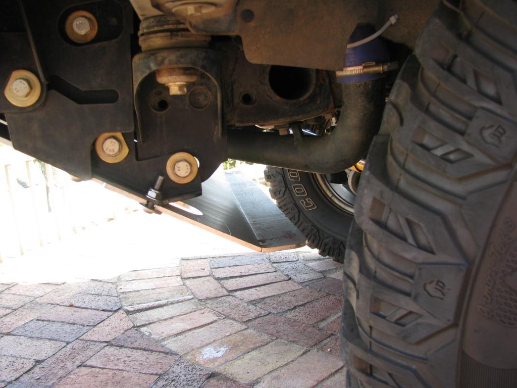

It gives all the necessary protection for my intercooler pipes etc.

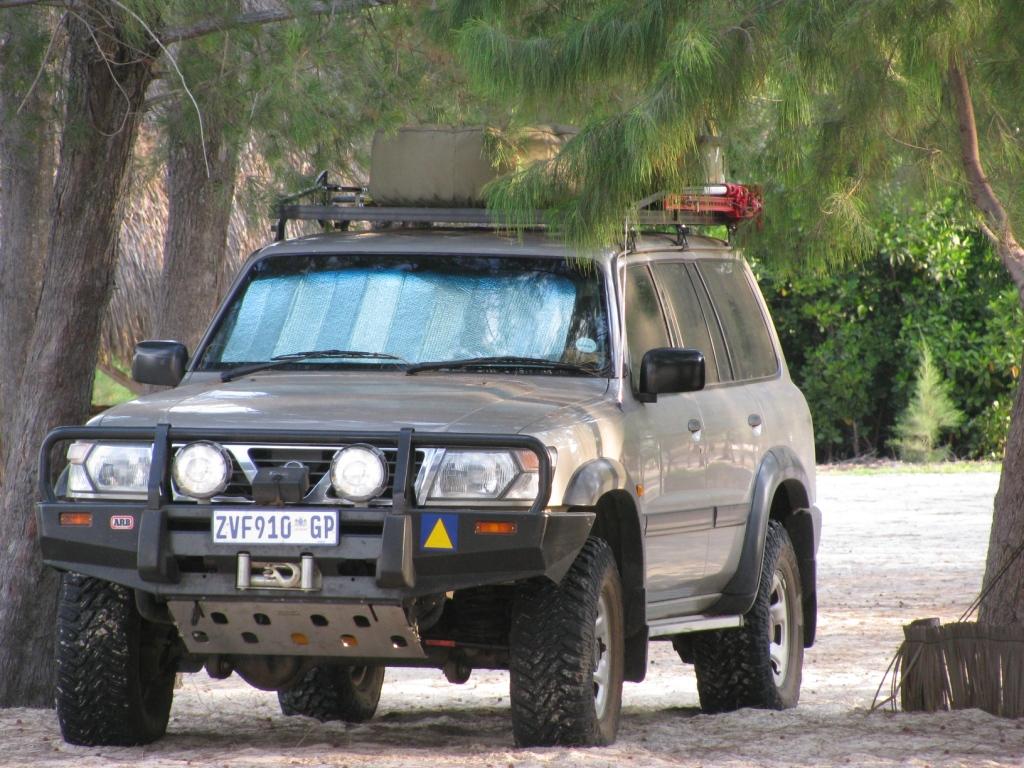

And does a lot for the front end looks :biggrin:

The bottom 1/3 of that plate is entirely unsupported, and that is exactly where I would expect it to need strength?
While it looks great, in my opinion it is almost useless. If you guys give me till desember, I am sure I can come up with something better. And since I know what he paid, I can confidently say mine will be cheaper too.
