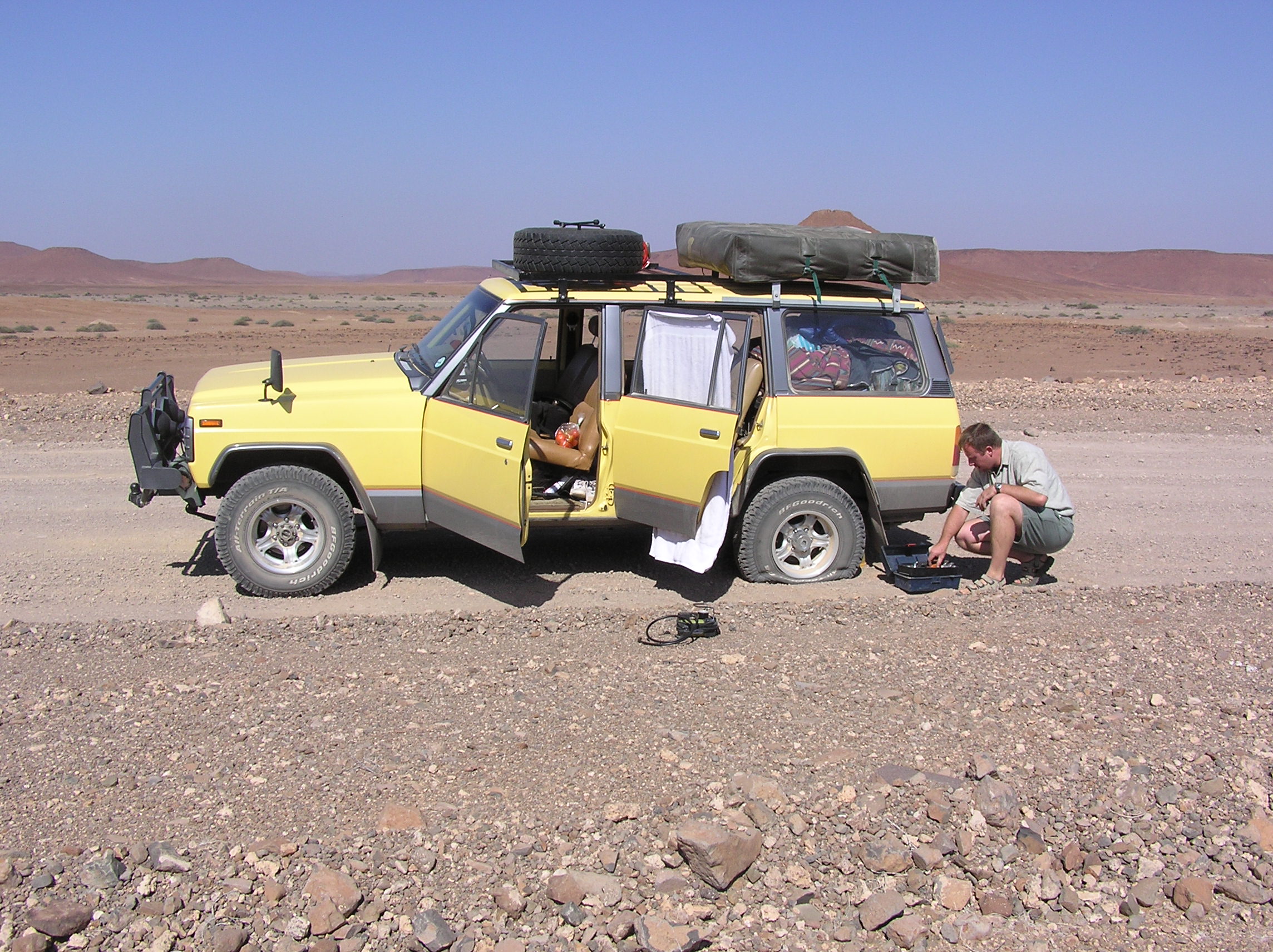

JohnBoyZA : I too believe a tyre should mould over a rock - but only for low speed crawling. I have however lost a BFG A/T with a puncture in the middle of the thread area caused by a stone which makes me wonder if my tyres weren't too hard?
Namibia 2004-05-29 084P.jpg (818.43 KiB) Viewed 3351 times
If you haven't lost a tyre you must be doing something right! What pressures are you running?
