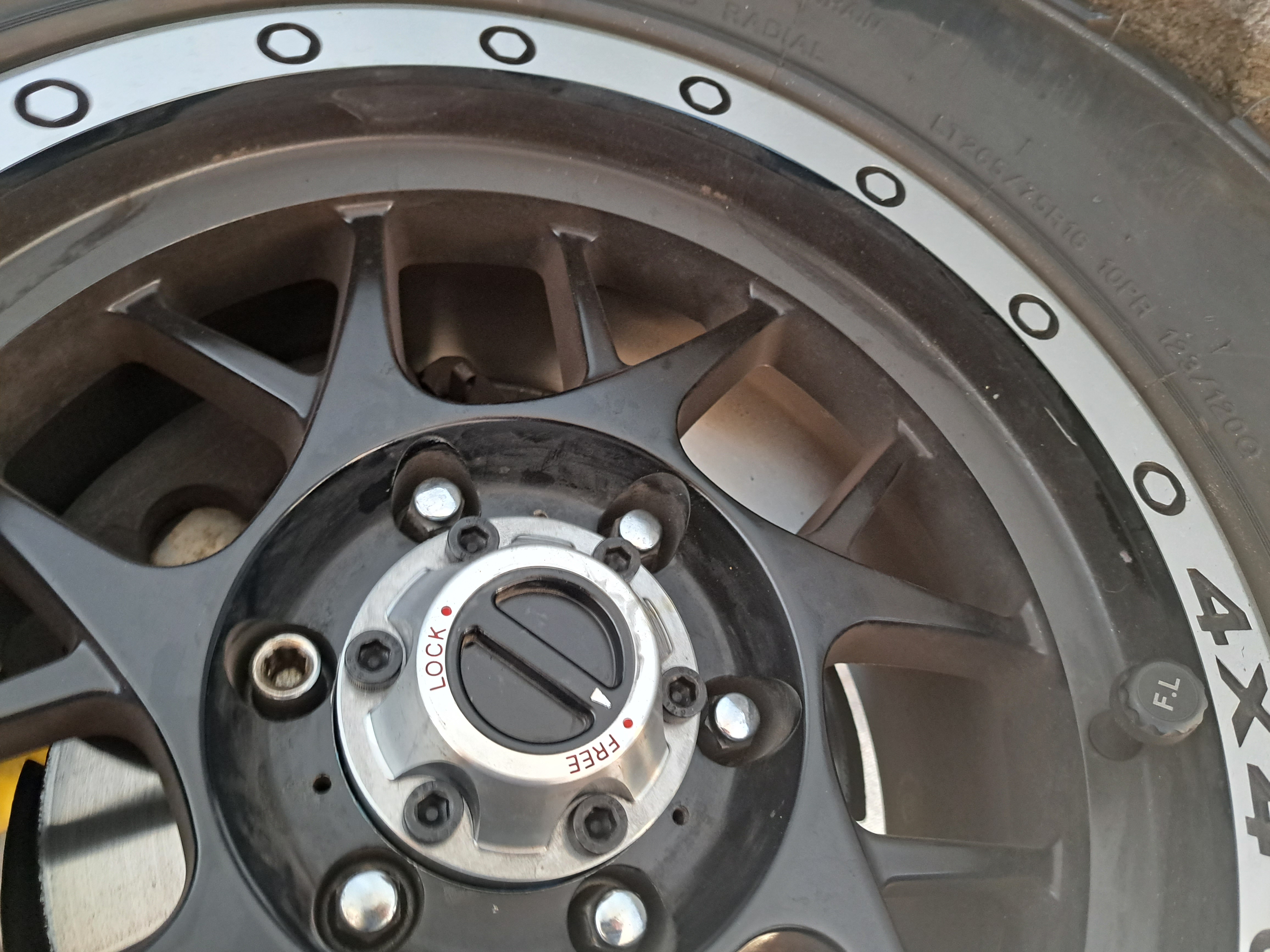

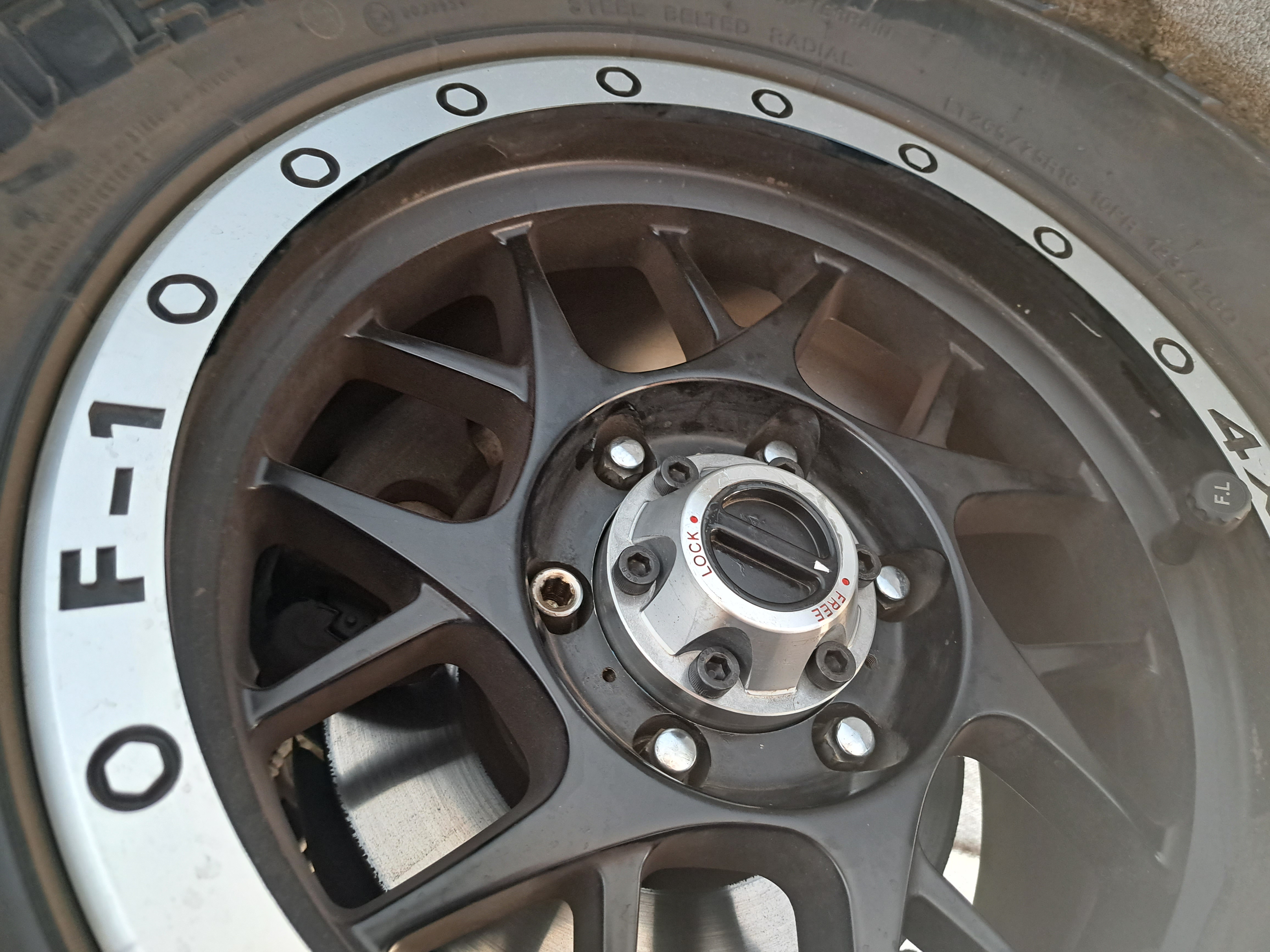

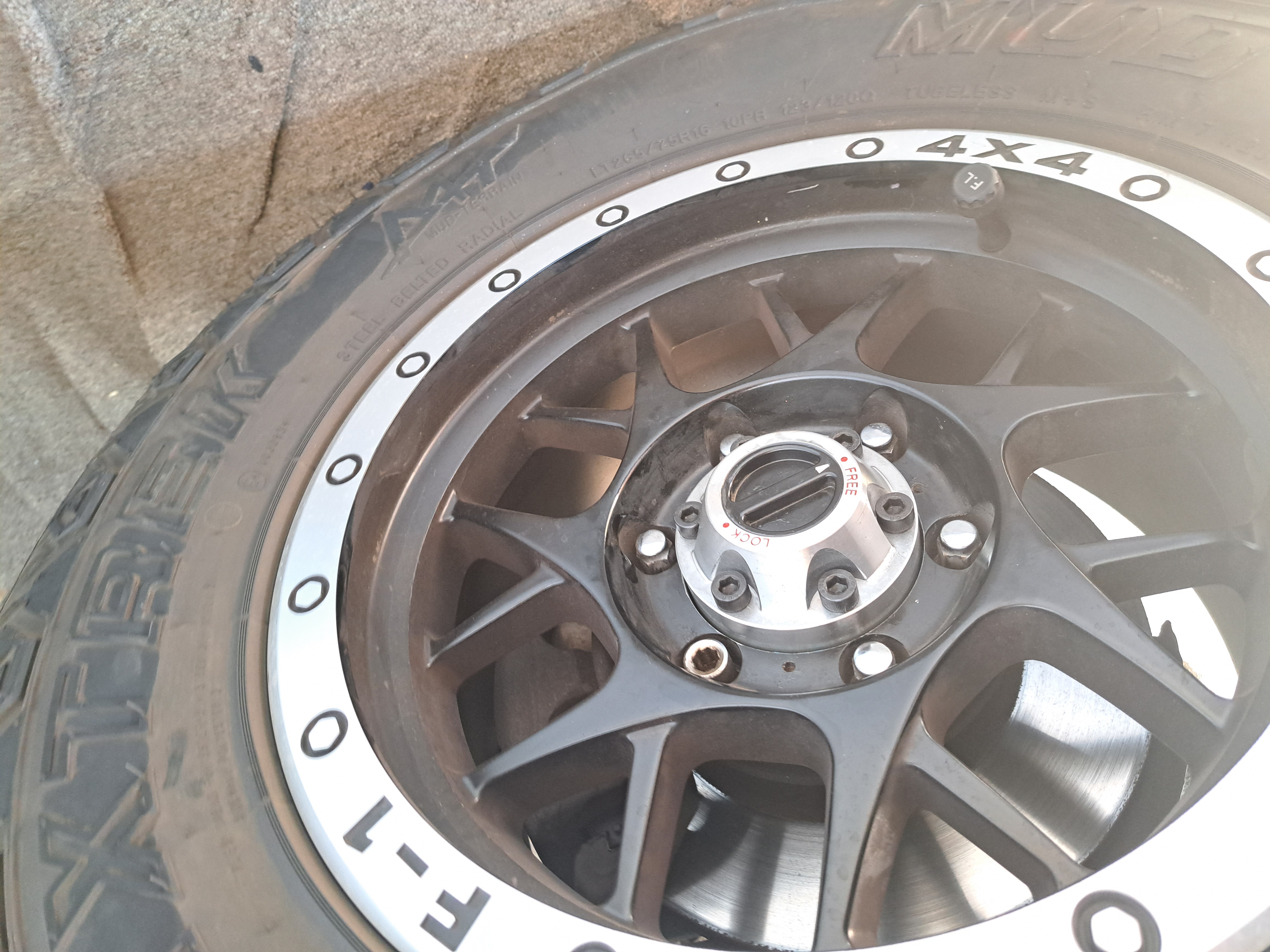

Good morning all.
Finally got mine fitted. Had to machine 0.50 to 0.60mm off the eggring to get circlip in. :oldtimer:

Hi Tinus, bought the hubs by David Volschenk, hubs are plug and play except for the geniune Nissan bush bought additional, and the relocating of the existing 2 x spacer washers and 1 x circlip, 2 x spacer you through and only relocate the 1 x circlip from inner goove to outer groove. Only slight problem, I had to machine down the bush so I could get the circlip into the outer groove. The hubs work 100%. The fitting was very easy and straight forward with these hubs from David, good quality to.
