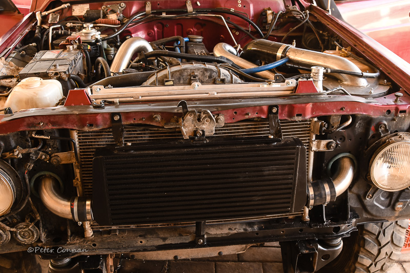

However, I have decided to take the next couple of steps.
Firstly, in another complicated three-way deal, Tinus ordered a 30% smaller intercoooler from Michael, and then swopped me the small one for my big one. This smaller intercooler is the same size Michael now runs on his own car, and on his it made a big difference to water temps due to it exposing more radiator to cool air.
I have now fitted this smaller intercooler. This is what the old one looked like:
And this is the new smaller one:
In effect, it is the same length and has the same size connections, but it is about 50mm or 30% narrower.
I am also taking this opportunity to re-locate my spotlights, moving them outward so they are not directly in front of the radiator anymore.
When lock-down ends, I also intend modifying the grill by cutting out the center portion and fitting a fabricated Aluminium one which has far more "slot" and far less "solid". But I can't do it until 1) the laser-cutting guys can do some cutting and bending for me and 2) I can get to somebody to weld it together for me.
Kind of throwing almost everything I can think of at the problem in one go now. If it solves the problem, I really couldn't care less which changes made how much difference...
