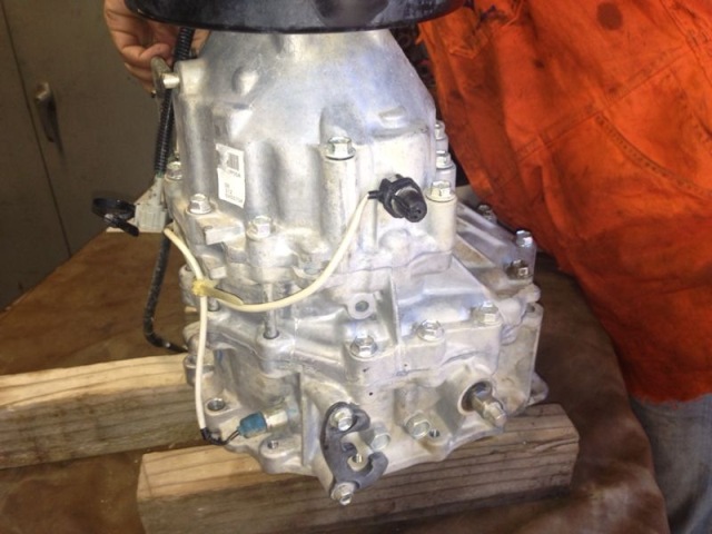

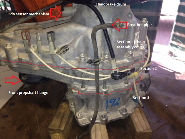

This is somewhat backwards forward, but as promised, here is a bit more. The purpose of this is to complete my experience of working on my GU 4.5 TX12A transfer case, and post as much as possible in an attempt to help others who may deal with the same or similar problems. There is a cost saving and quality control motive to it. After all, the purpose of owning a vehicle like this is to drive off into harsh, challenging and unknown territory (The Bundu) with the piece of mind that you dont have to walk out of there.
The TX12A common to the GU 4.5 and others.<br />Just to remind me where all the wiring and piping fit.

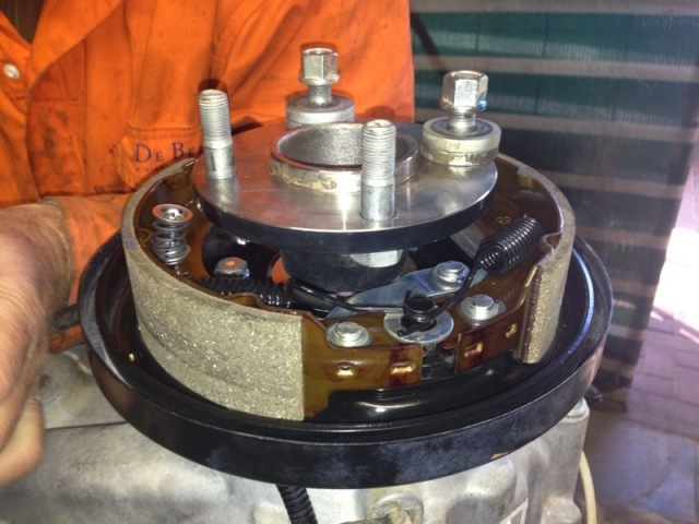

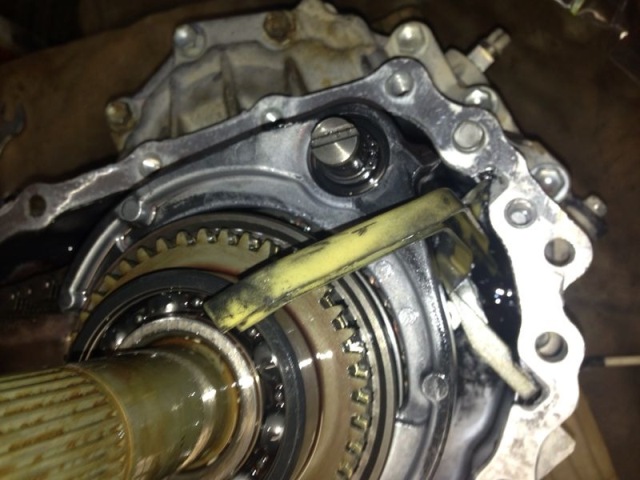

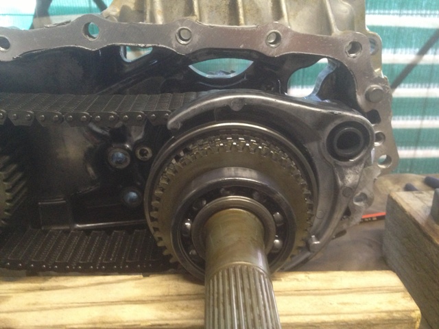

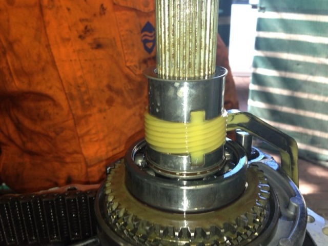

Here is the handbrake assembly. I did not disconect the cable in the drum but rather where the cable attach to a L shape lever arm on the chassis, easy.

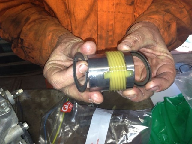

The location of the oil gutter, the orientation of the odometer gear with shims.
Just the mid section after the chain cover has been removed.
Hand brake mechanism with brake shoes
Oil gutter to oil the odometer gear, that bearing and to force-transfer oil to the chain section.

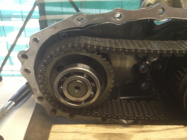

Rear section where the chain is located.<br />Bottom part shows the 4L gear.

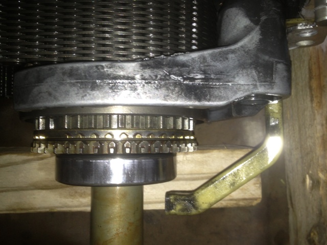

When shifting to 4H this selector engage the gears to start driving the chain
Slack on the chain, no problem. There was no chain wear marks on the chain gears.<br />Bet it will last for a very good while.
