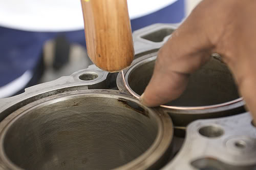

Just want to have some more info on this piano wiring the block.
Is this different from o-ringing the block where you have the engineers cut a 0.4mm groove on top of the sleeve and then you insert a copper/piano wire of 0.8mm inside the groove?
Like the following pics
Re: head coming off again
The principle is the same, just that the way you show is far more professional. The copper will squash and form to the shape and space between the head and the sleeve. For example if the one side of the sleeve is 0.1mm lower or higher than the other side, the copper ring/wire will squash to form a perfect seal. On my block I notices that the sleeve is some places was slightly proud, but still way below max spec and other places were flush or a fraction below the height of the block. The stainless shimstock I used ( used stainless due to its high melting point, and that they didn't have stock of copper shimstock ) i cut into rings that sat perfectly on top of the sleeves. I lay them on the sleeve tops and placed the head on carefully to ensure that the rings don't move at all. This creates a perfect seal between the head and the gasket and a perfect seal between the head gasket onto the stainless ring and the sleeve. If I recall correctly, I didn't use the thinnest head gasket, and was working on the principle that there was more "spongyness" in the thicker head gasket and that with the massive torque on the head this would give a better squeeze onto the rings and sleeve tops.
I have since done 65 000 Km and service EVERY 5000Km on this motor. I don't play silly buggers when I drive, I work the motor..... I don't abuse the motor, but I use that 4.2L like it should be used, and whether loaded to 3.5ton pushing through Botswana snotty mud in the pans, or through the snow in Lesotho, that motor chugga chugga's like a sweet kitten purring with laryngitis....... :rolling:
Would I Piano wire the block over putting the rings on...... yip that's a much better way to do it. My way was a little cruder and cheaper, but done properly the effect is the same. I recon that motor of mine will still comfortably do 500 000Km!!

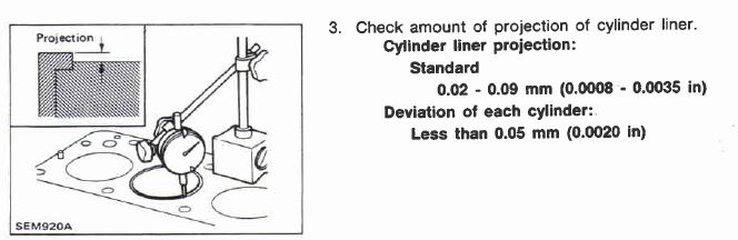

Cedric,
Is the spec not 0.02mm to 0.09mm for the sleeve projection?
I found this in a manual I downloaded but not sure how it compares with yours
Oops yes sorry..... then I think my shim stock is 0.05mm. That zero can make a BIG difference....hahaha
Was nearly 4 years ago that I did the rebuild :redface: :redface: :redface: :redface:

Jip cedric, I nogal spoke to a guy that builds race and drag engines his opinion was the whole piano wire thing is a load of rubbish but admits to having done it to some diesel race car in the past only cos they were running 2.8bar boost. My engineer said to me today that its going to be a task to get the sleeves absolutly right, with a range of 0.02 to 0.09 what should mine be?
