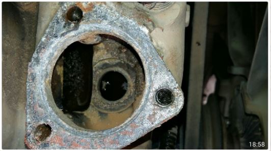

thanks for helping. The problem is solved for now. appart from the broken waterpump i was also using the wrong thermostat. Got a new one, and now my temp gauge stops at 98º, since saturday. I wanted to show u the pics for the thermostat house but, still triying to figur out how to upload pics.

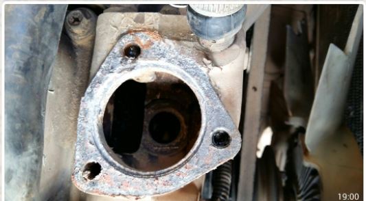

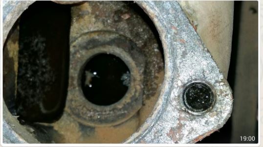

Have a look at the pictures for the thermostate housing.
Thermostate house
Thermostate house
3 Capture.JPG (38.38 KiB) Viewed 3359 times
Thermostate house
Thermostate house
2 Capture.JPG (36.7 KiB) Viewed 3359 times
Thermostate house
Thermostate house
1 Capture.JPG (37.44 KiB) Viewed 3359 times
