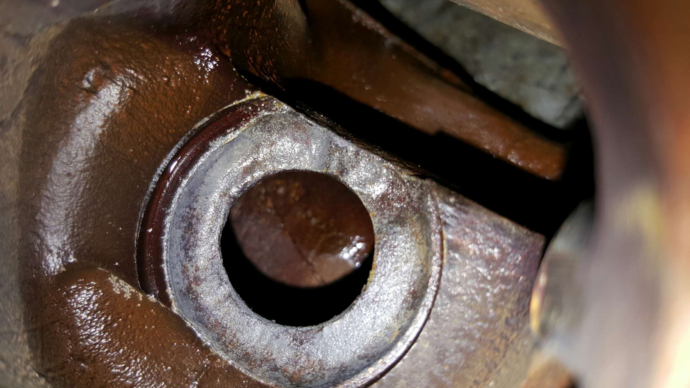

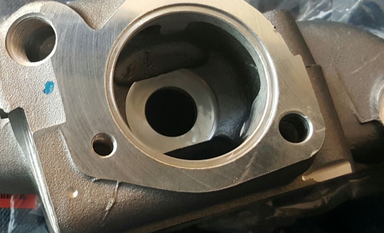

Here is something you should look at when inspecting the thermostat housing.
The area that needs to be blocked off must be in good condition, if it is pitted you will need to replace it or get it "modified" to get it working as it should.
here is a pic of a badly pitted housing. this was in my own Patrol and the water was running warmer as it should"
Here is the new one, you can clearly see how it should look where the thermostat needs to block off the hole.

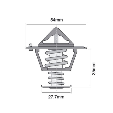

Forgot to add, just verify that your thermostat looks and measures like this one.
- Original Thermostat.jpg (14.1 KiB) Viewed 8931 times
