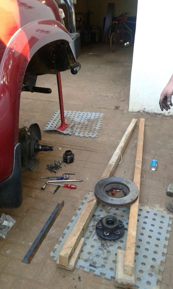

I have tried to push the jack over / try to push the vehicle of the jack in this position: http://patrol4x4.co.za/download/file.php?id=15803
But was not able to. decent jacking points makes a moer of a difference wrt safety when using a hilift jack.
(the jack got stuck due to dust/debris, and did not want to lower. Few squirts of q20 fixed it...)
I also always put a piece of rubber/foam mat under the hilift to prevent it from slipping.
I have changed a lot of tyres on my patrols, swapped tyres, swapped wheels, rotate wheels etc. I always use the hilift jack. When used correctly it is perfectly safe.
