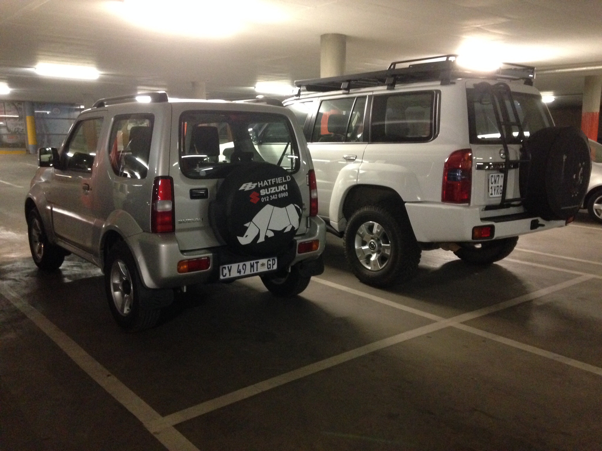

So cannot get a smile off my face. Graham from G-Tech did my suspension today, and WOW !!
Installed OME - 70mm lift
Not only is he a Guru, but also is his advise unbelievably excellent - Fenks sooooo much Graham !!

Just need some big wheels now ....looks good man.....did you fit caster correction bushes?

Look good ya.
just a word of avice. 50mm and up, the caster ofset bushes are not enough for a Patrol. I have found most of them to "turn" back, and if not the car attend to the death wobble side.
I slot the bracket on the diff to tip it backwards. Then weld washers on the outside off the bracket to get the hole round again.
If you have 3 degree caster, that is not enough. The wheel aligment guys will differ from me.
Its all about the raidius arm angle. Gman on the forum sell drop boxes tosort the radius arm angle.
