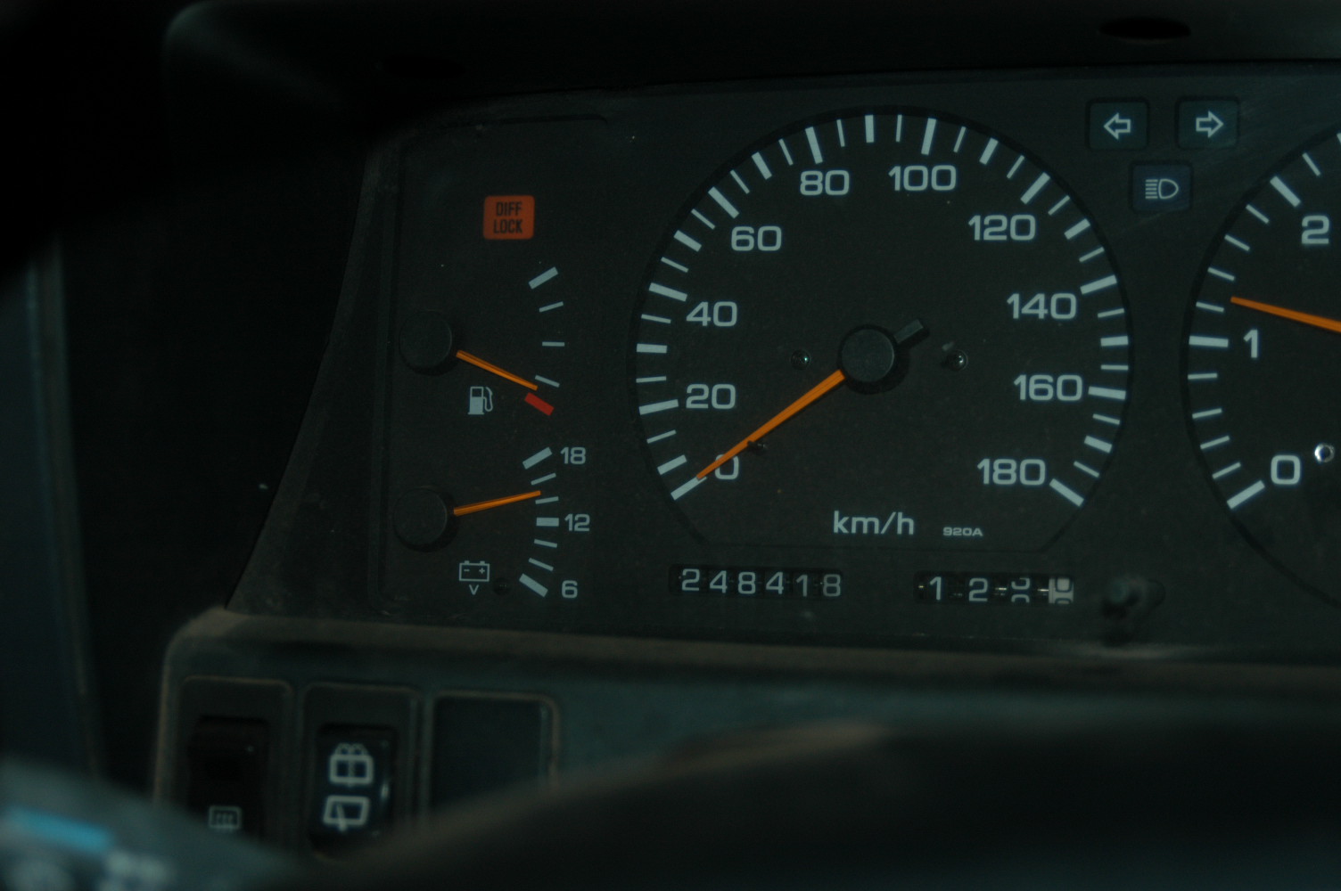

Wouter the difflock warning light is on the other side of the instrument cluster, at the top left.
If I remember correctly it is orange and says "diff lock" (not a picture), but I am not sure now. I will try and post a photo for you tomorrow unless one of the other guys beats me. Be advised though on our old patrols, this light never flashes. It is either on or off, and it will be off when you switch the difflock switch on, it will only light up when the diff actually locks up.
If you are still unsure of wether the diff lock works, I would recommend the following test:
1) Chock up the two front wheels.
2) Place both the gearbox and the transfer case in neutral.
3) Jack up one of the rear wheels using the vehicle's jack.
4) Start the engine and let it idle, and release the handbrake.
5) Turn the rear wheel that is airborne, to ensure that it turns freely.
6) Switch on the diff lock, and turn the rear wheel again. The difflock should engage before the wheel has turned fully around. Only now would the come on.
Be carefull not to drop the car on you, and remember to switch the difflock of before you lower the car.

Re: Tell me everything about my Patrol
Here you go Wouter:
I hope you see the (this) light soon?
