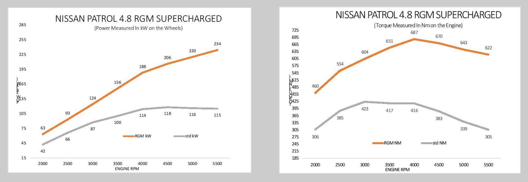

It appears from my research (I have a lot time on my hands :blonde: ) that the supercharger option version is the most effective from obtaining torque evenly through the rev range. I have attached a dyno stat from one of the companies that apparently was from a real life car they did. +-R125k quote to do that. (I'm sure it can be done for about 80k but I don't have the data to back this assumption up.)

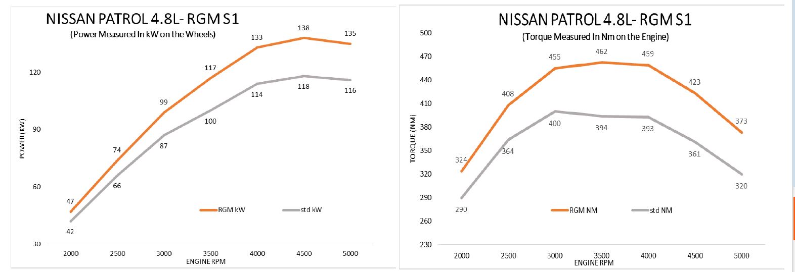

And these are the actual results from: free flow exhaust (no branches); Unichip; K&N air filter,
