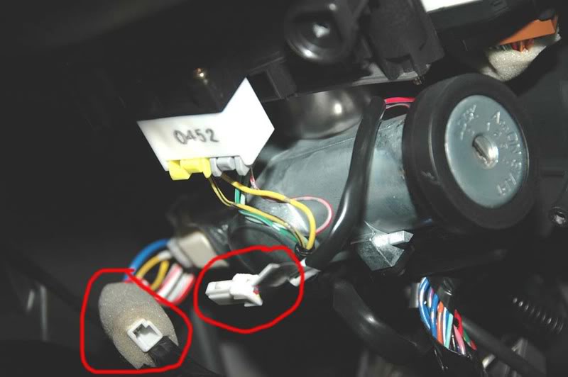

Re: Key in ignition chime
Maybe this will help:Chris Skinner wrote:Anyone know where the little buzzing device is situated??
"1. Remove steering column shroud
- 3 screws
- remove key surround
- with a small screwdriver, gently force the two shroud sections apart.
Insert the screwdriver where the 2 stalks enter the shroud. Only the bottom section of shroud has to be removed fully.
2. On top of the key cylinder 2 wires exit with black tube wrap, going to a white plug - for 4.2 models. For 3.0 models the plug is brown. This plugs into a white socket which is wrapped in foam around the black wiring loom. JUST UNPLUG IT!
3. Replace the shroud
4. Enjoy the silence"
See here: http://www.patrol4x4.com/forum/nissan-p ... post160197
And here: http://www.patrol4x4.com/forum/nissan-p ... ost1027060
("Just be aware that disconnecting this will also disconnect the "headlight on" warning. (Did in mine anyway). I put a switch in the circuit so that I could switch off the beeper if it became annoying - working with the door open for instance, but at all other times it is switched on."
Reply: "Mate I think you may have disconnected the beeper instead of the sensor on the ignition barrel itself. There should be no reason disconnecting the key should affect the headlight alarm. Certainly didn't on mine. ")
- Keybuzzer.jpg (44.56 KiB) Viewed 6846 times
