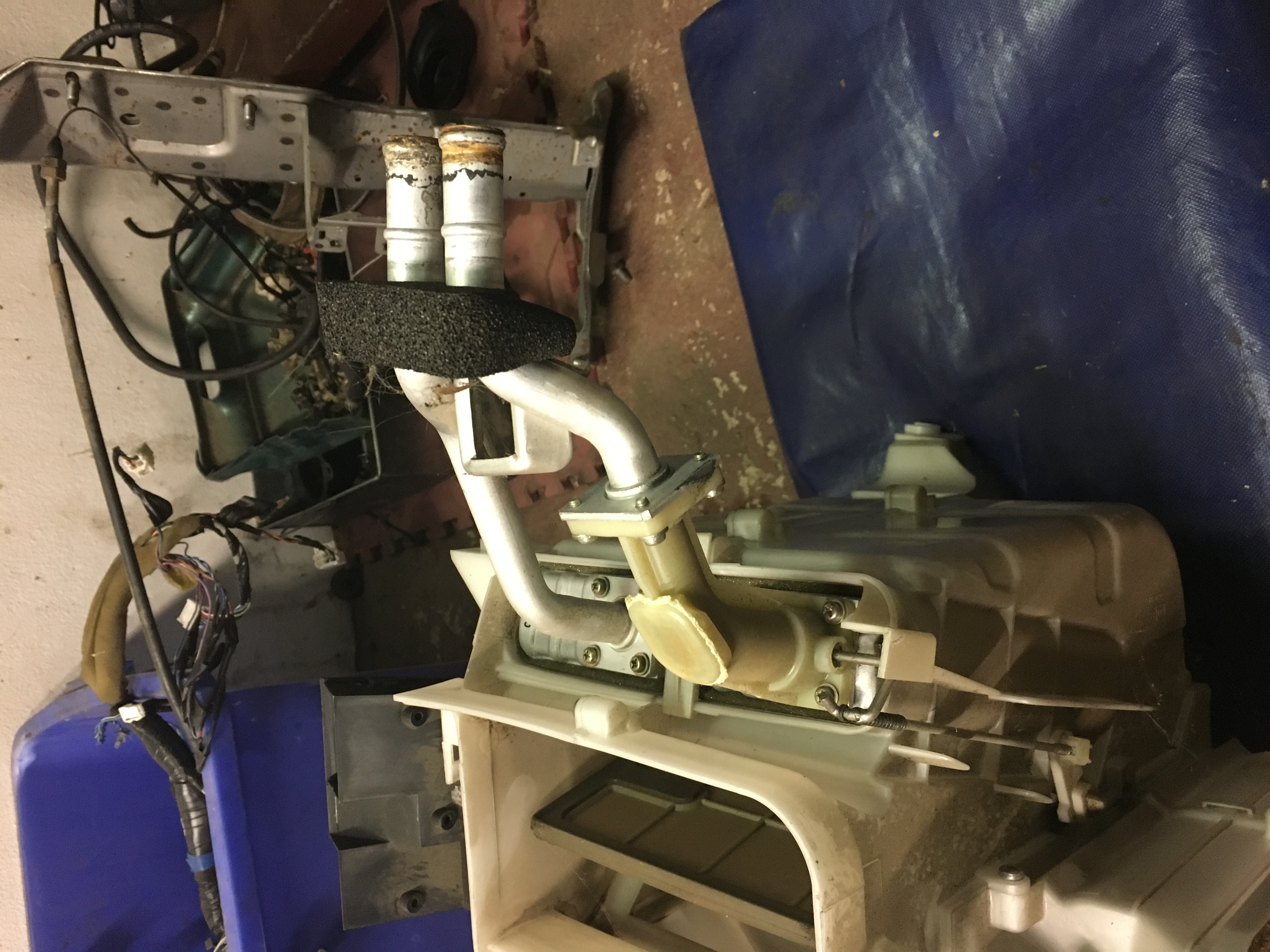

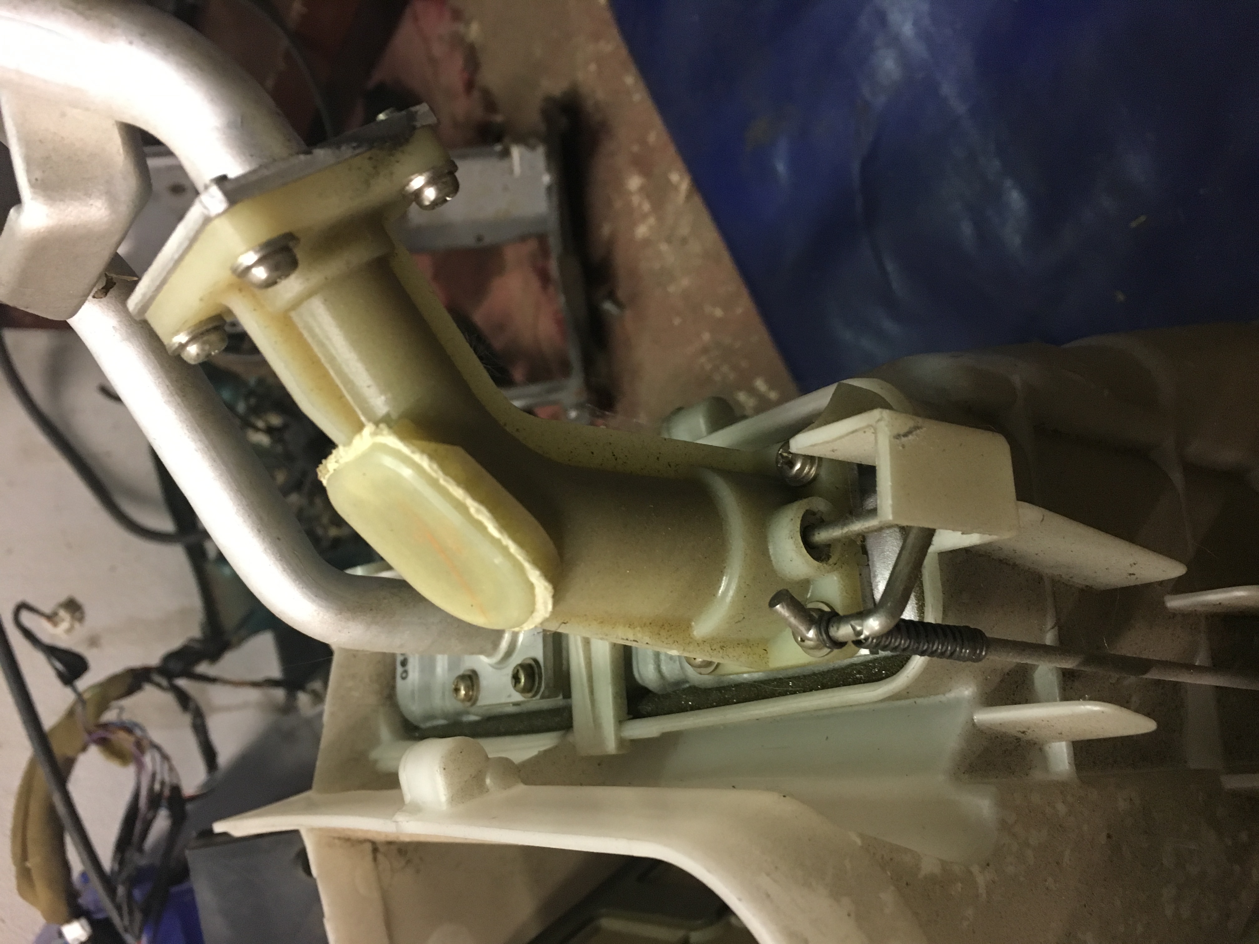

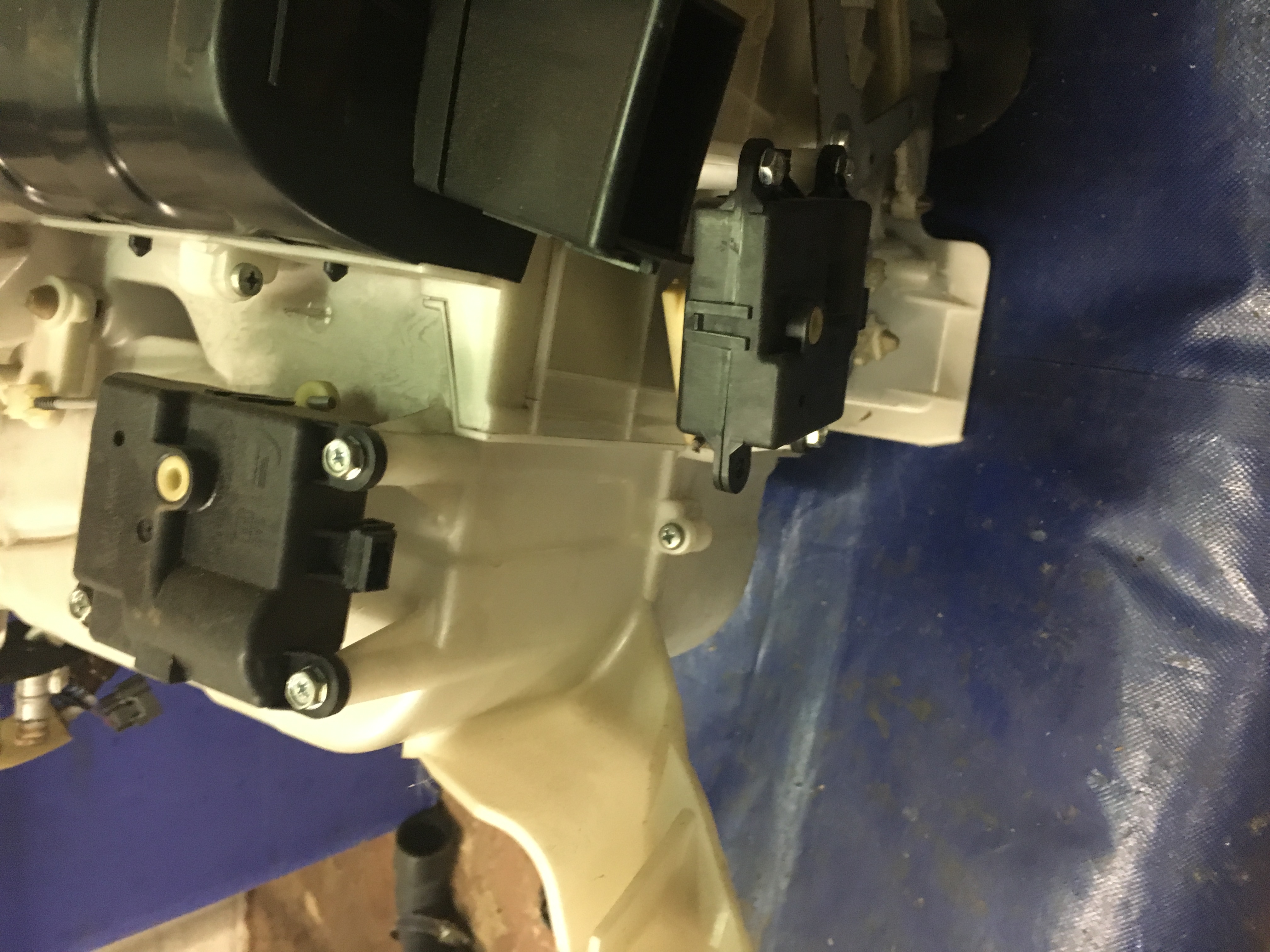

Chris here is foto,s of where to look if you didn't come right
