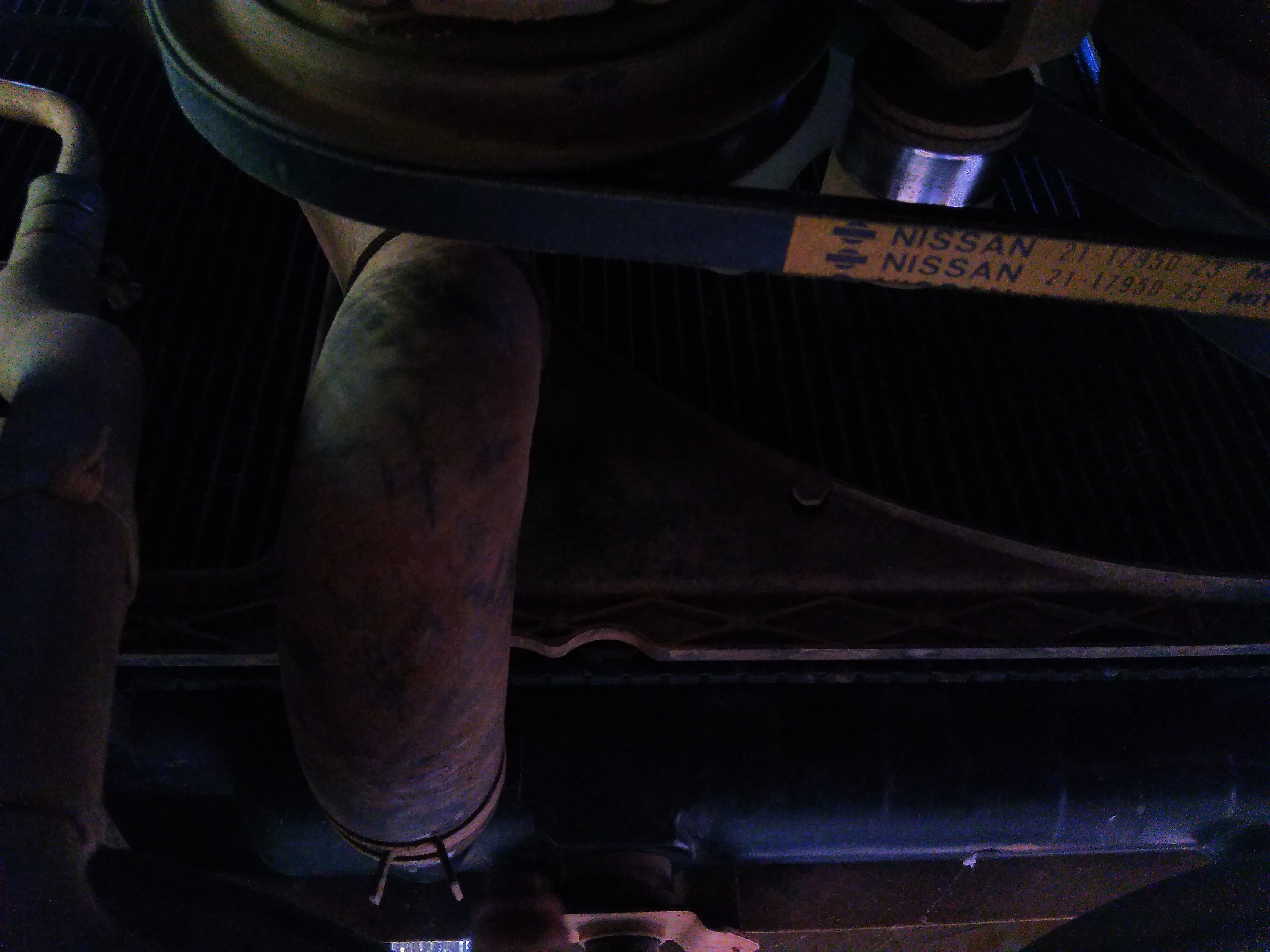

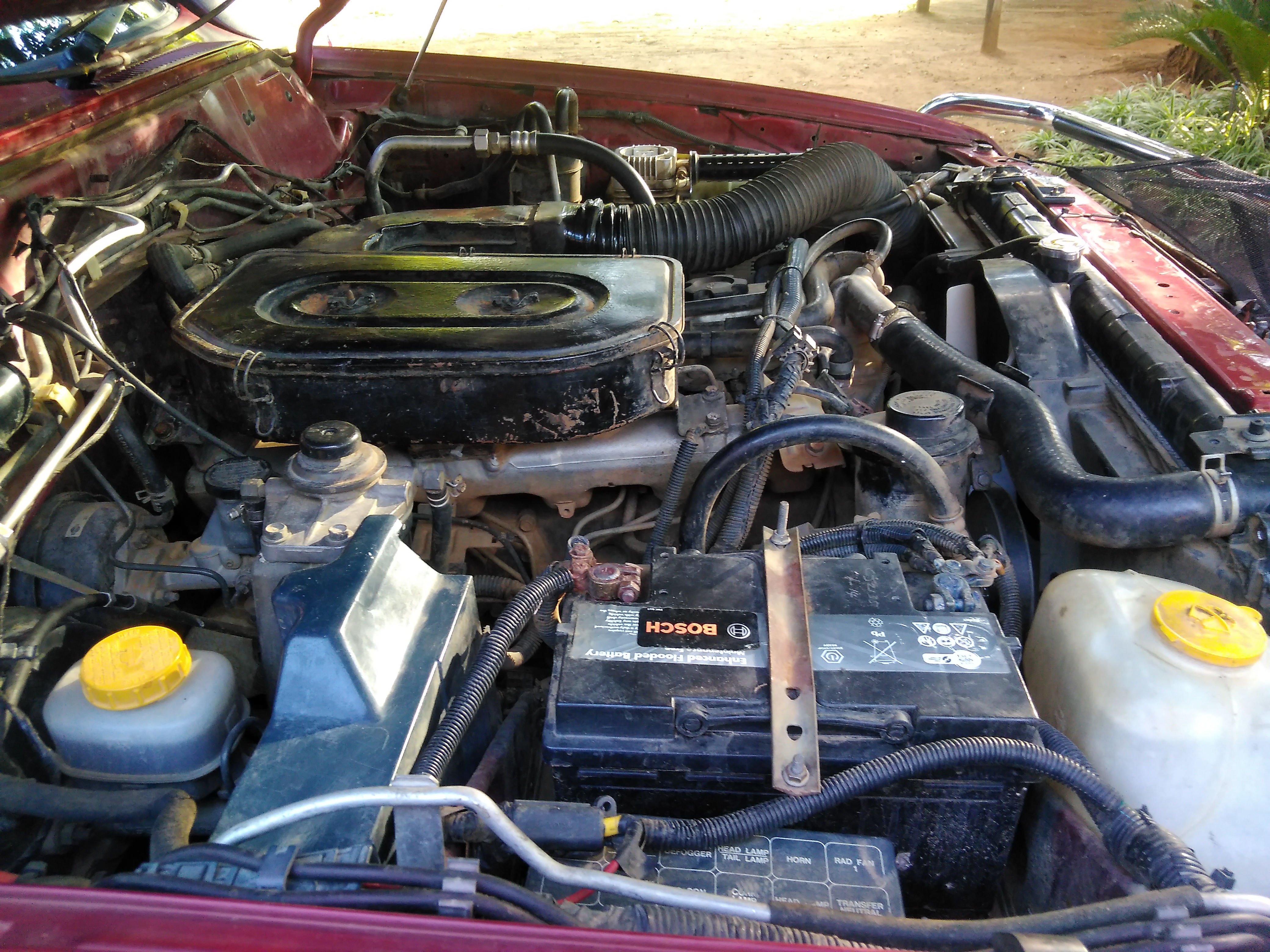

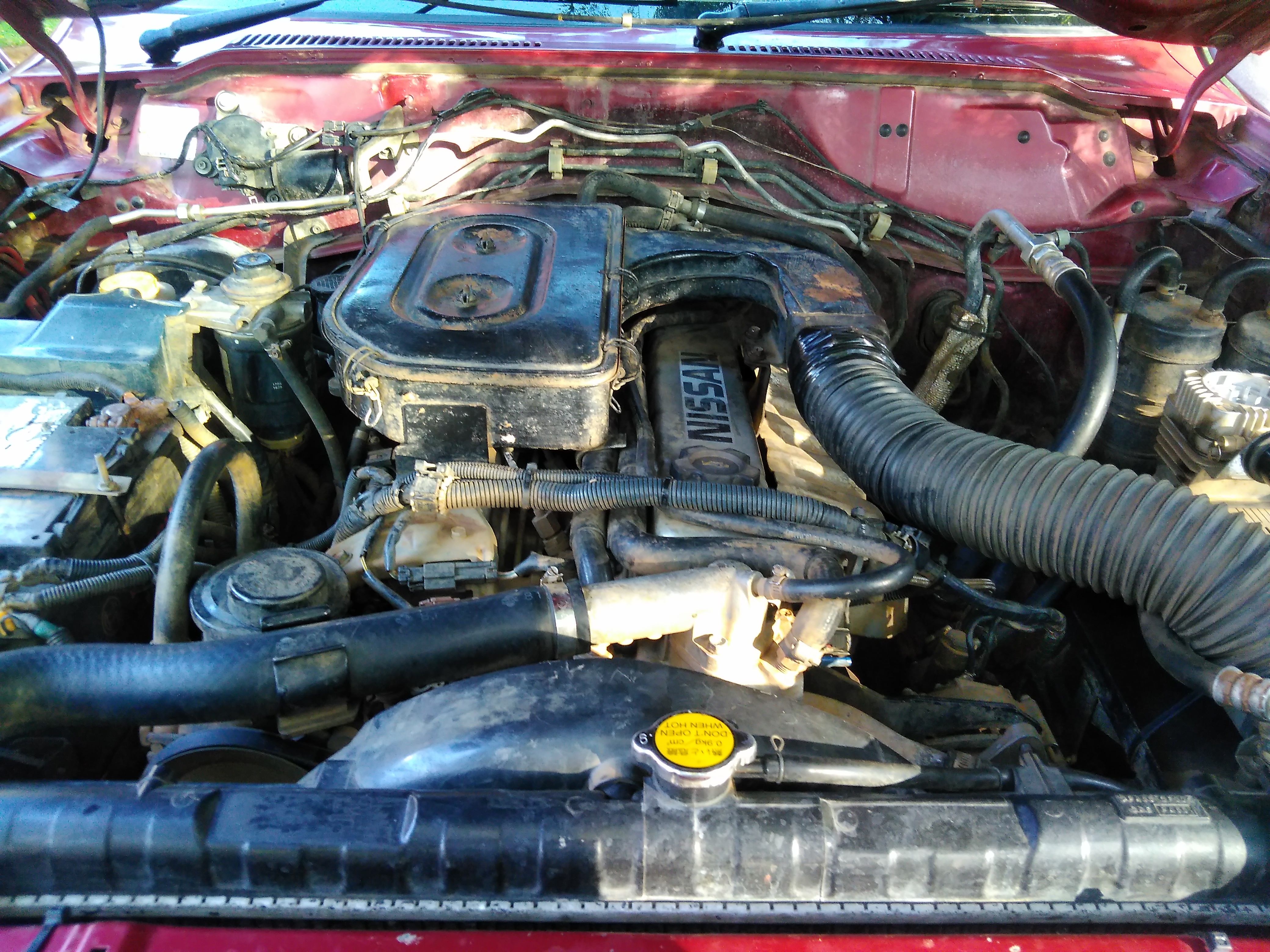

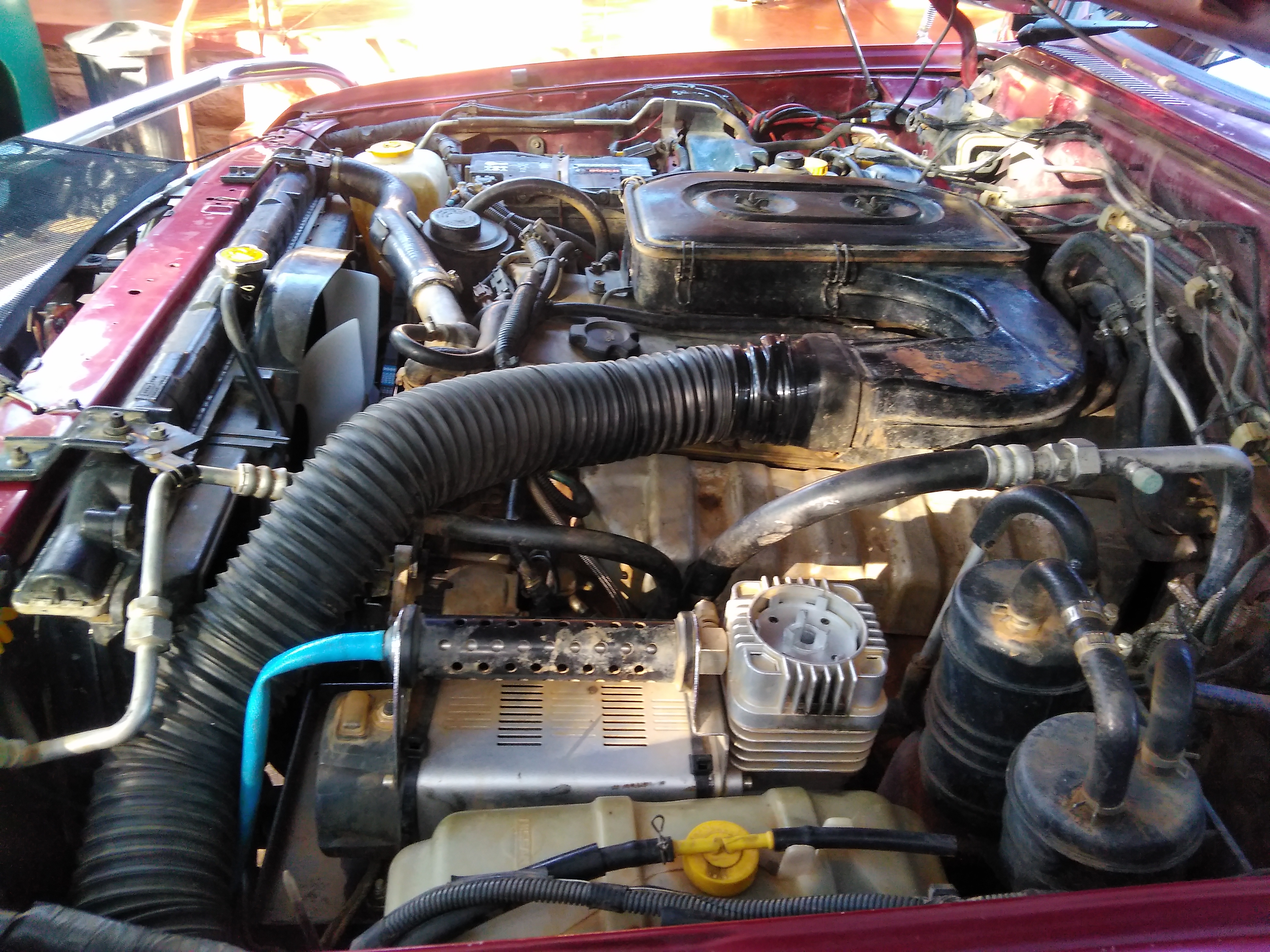

I have a sneaky suspicion that either your Patrol was one of the first GU (Y61) Patrols here in SA that landed up with a ( dare I say it.....) silvertop TD42 motor in, but this I think is VERY unlikely, or the original motor was changed and a (GQ) td 42 motor was fitted into that Patrol. This makes VIN number checking a waste of time unfortunately. Take a few pics of the engine bay from all sides as well as a clear photo showing the bottom radiator hose, as this is way different between the GU ( Y61 ) and the GQ (Y60 ) and post them here so we can have a look. We should be able to see the subtle differences to confirm this.

ricster wrote:I have a sneaky suspicion that either your Patrol was one of the first GU (Y61) Patrols here in SA that landed up with a ( dare I say it.....) silvertop TD42 motor in, but this I think is VERY unlikely, or the original motor was changed and a (GQ) td 42 motor was fitted into that Patrol. This makes VIN number checking a waste of time unfortunately. Take a few pics of the engine bay from all sides as well as a clear photo showing the bottom radiator hose, as this is way different between the GU ( Y61 ) and the GQ (Y60 ) and post them here so we can have a look. We should be able to see the subtle differences to confirm this.
OK chaps, took a few pics.
Tour de Frans reckons its a silver top.

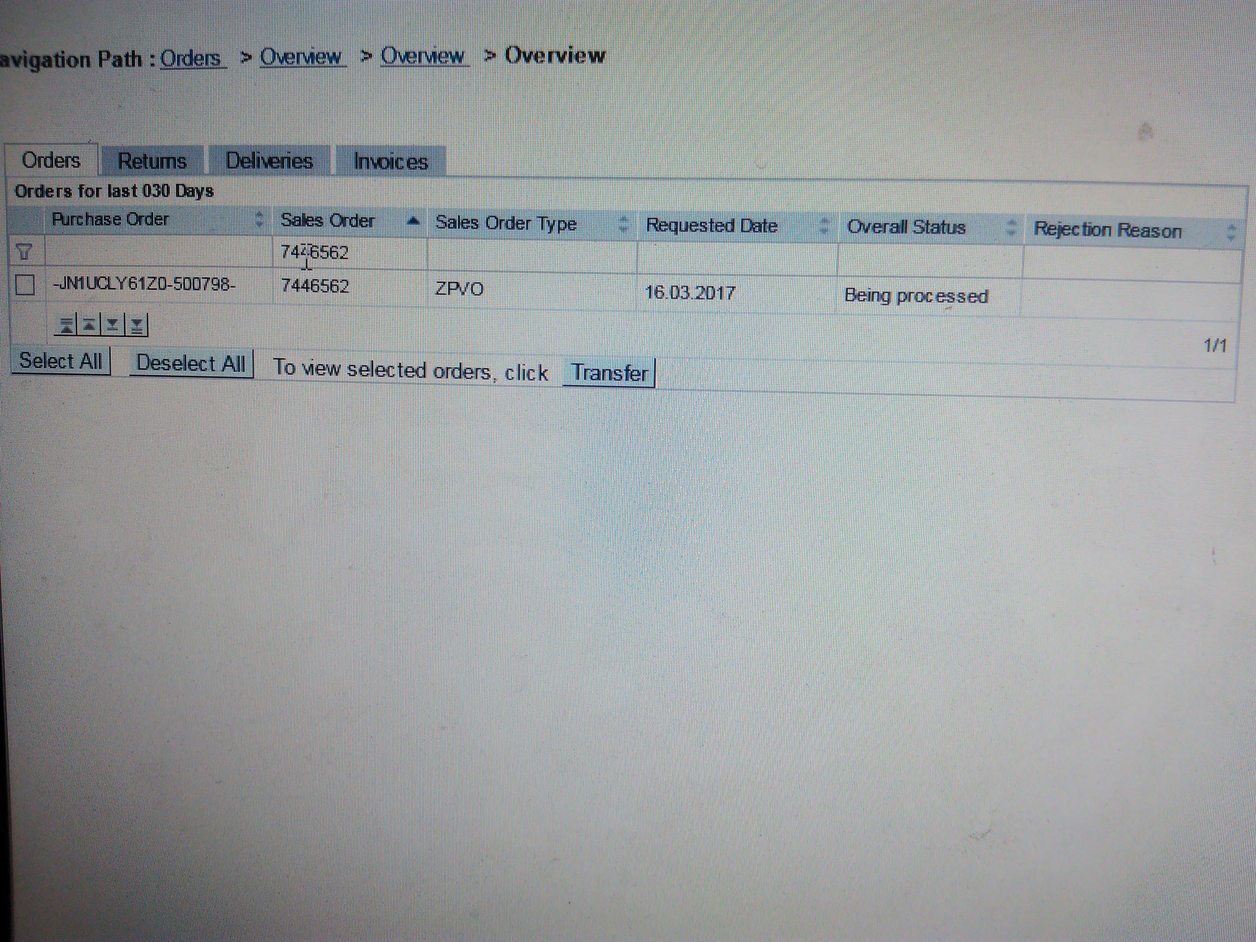

Nog 'n ding, en dankie vir daai raad oom Mac, ons het die seel by UD Trucks opgespoor! Sal Donderdag hier wees.
Hier's 'n pic van die bestelling by Nissan geplaas.
16/3/2107 bestel, ETA is nou 2/5/2017. Liewe land die Japanees se rubber dinghy het seker 'n puncher gekry toe hy uit die hawe uit roei... :mytwocents:
Gelukkig het UD Trucks (Nissan Diesel) voorraad in hul ware house. Onthou dit :oldtimer:
