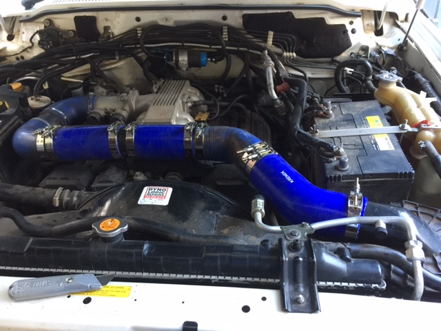

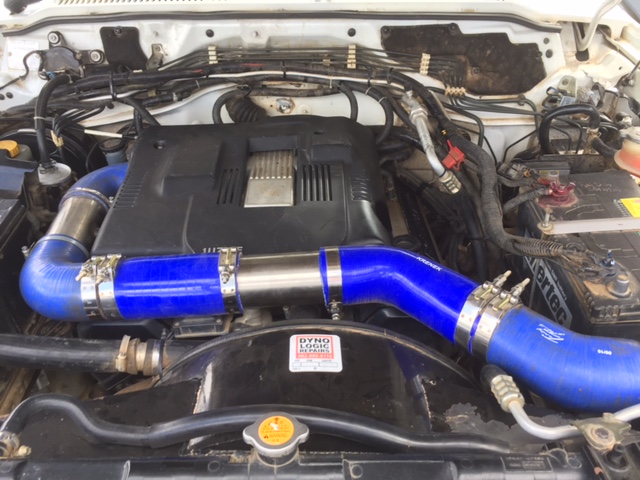

So this issue came up on the river trip and again at Rust de Winter.
Below is a description and pictures of what I had done.
I was referred by Errol to a friend that does Lexus conversions (his owns a Landrammel and Navara with Lexuses in).
(while I was there another Navarra with a dead 2.5 came in for an op)
We started by using a water spray gun while the car is idling, and target specific areas of the engine.
The timing sensor on a pulley (which I always thought was the issue), got soaking wet and the engine was still happy.
However after spraying the coils and allowed water to drip over the area where the injectors are (on top of the engine), it started to stutter.
Now the simple riddle: How does the water get there, if my engine starts to stutter when it is only 50cm deep?
Well, this is presumably due to the fan that does the spraying!
May engines (I suspect the TB range of Nissan included) is resistant to this.
But the Toyotas need protection from water.
So the suggested solution is an engine cover (which we then ordered)
See the pictures before and after below.
The air intake had to be adjusted slightly (notice the two stainless steel parts) in order to make space for the cover.

Awesome news Alex, glad you actually got to the real source of the problem.
I can just imagine how anyone must feel to fear water crossings as they are generally fun and exciting.
I'm sure the engine cover will do the job. You can maybe also look at modding the cowling a bit so it does not splash water over the engine as much or is that just not possible?

Hi Alex,
I had similar issues with my Lexus (with an engine cover). I too had stuttering & even lost cylinders when water was involved.
My issue was that the spark plug tube & coil pack assembly were not seating properly on the heads, there were circular rubbers that had shrunk with age & water was getting in through the gap.
We fixed this by getting new rubbers & also sealing the faces with a tiny bit of forma-gasket.
I still however from time to time had a cough or two when playing in the water.
J
J

Thanks, I will look at that next.hugejp wrote: My issue was that the spark plug tube & coil pack assembly were not seating properly on the heads, there were circular rubbers that had shrunk with age & water was getting in through the gap.
J

I have the exact same problem with the Lexus motor I'm busy with. Luckily mine is going into a road car, so apart from deliberately spraying water on the engine it should not be a major issue....hopefullyhugejp wrote:Hi Alex,
