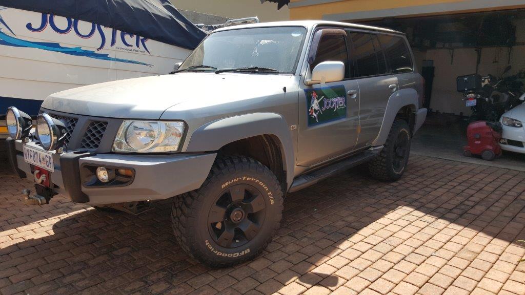

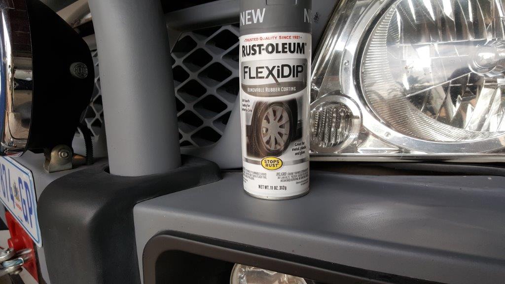

I did my rims with plastidip about 15 months ago - since then 3 times to Moz and towing on really bad roads/dunes/beach - still looks great...
Definitely recommend... but would use a newer product called flexi-dip - its a product made by Rust-o-Leum and sold in the spray can section at Builders.
I did my bumpers and wheel arches and grill with it and it seems a bit more forgiving and easier to apply.

Chris
How do you apply the coating and what preparation is required?

Black rims is on my to do list... will give this flexi dip a try..Chris Skinner wrote:I did my rims with plastidip about 15 months ago - since then 3 times to Moz and towing on really bad roads/dunes/beach - still looks great...

Re: Side-Steps, Old-School Panel-Beating and Plastidip...
I did a post and some pictures of how to do it - go to following link:
Very easy - clean well, mask tyre with cards as in the pictures, and go for it... light coats initially and then heavier. Give at least 5-6 good coats... more layers the better. Avoid running paint. Do it a well ventilated area as the fumes are not good for you
http://patrol4x4.co.za/viewtopic.php?f= ... s&start=50
