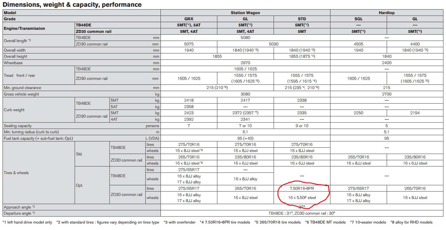

Michael wrote:Watse size is die steelies op my Patrol? 6j of 8j?
Ek vermoed dit is 8j.
My bakkie sin is 6.5jj.
Maar mens kry patrol steelies ook in 5.5j, 6j, etc..
(op die patrols wat in ander lande beskikbaar is, soos bv die gl standaard modelle sonder wiel flares etc. hulle kom uit met 235/60r16 wiele....soos hierdie een: http://www.patrol4x4.co.za/viewtopic.ph ... 100#p73446).
Ek sien die nissan-aid patrols kom uit met 8jj,6jj en sommer ook met 'n 5.5 rim met 7.5r16 wiele :surprised: Dan will julle my k8k gee oor my 255/85's :lol:
http://www.nissan-aid.com/en/web/nscupl ... _sheet.pdf
NMAD

Yes this is correct and remember those Nissan Aid Patrols are used by the UN and military with those wafer thin tires and they pack them full of soldiers/equipment etc.
I wonder how it would handle on the highway at speed with those thin tires?

Well I did measure Tinus's rims and I got a reading of 8 inches from the inside to the outside of the rim.
Mine measures 9 inches, so not sure exactly from where to where it must be measured

Michael wrote:Well I did measure Tinus's rims and I got a reading of 8 inches from the inside to the outside of the rim.
if its an OE Patrol stel rim, it will be 8J :mytwocents:
