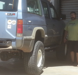

davidvdm
Posts: 629
Joined: 13 Sep 2011 15:47
Full Name: David vd Merwe
Nickname: David - Hillbilly
Home Town: West Coast
Has thanked: 4 times
Been thanked: 48 times
Re: 15" rims
Post by davidvdm »
ricster wrote:And those Kumho KL71 tyres on 15" rims is sooooooooooooooo sexy !!!!
Tyre Porn, Oh my!!
When I went to the old Safari axle on my Sani, I had a problem with my steel 15" rims fitting, where my Sani Mag had no problem. Some steel rims have two "step downs" to the center. The first takes it down to 14", the second to 13", and it's that second step that gets in the way of your caliper.
I then got a set of 8J that only has one step, but only found a set of four. A forum member here said they had a spare one that I could fetch, but I have not got out of town to do that yet.
I m running 33x12.5x15 on a -40 offset, and can see how the 12,5 tyre stands out from the 8J rims. I personally think you should be looking at least at 10J rims if you want to go with 12.5 tyres.
They were originally white
2015-12-20 18.56.04.png (140.68 KiB) Viewed 4324 times
