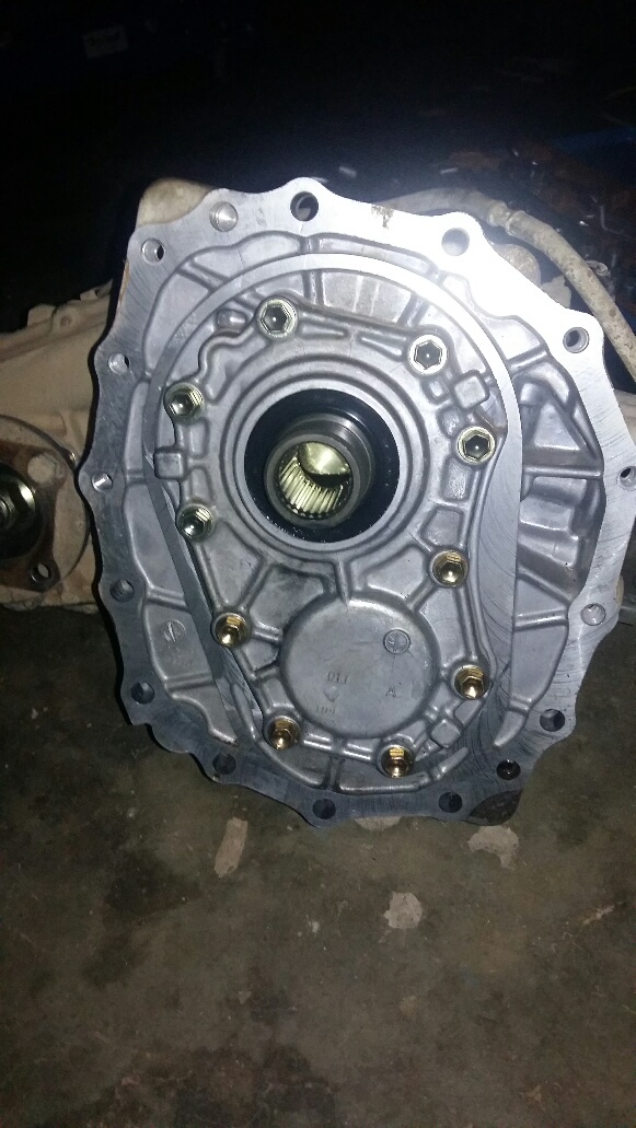

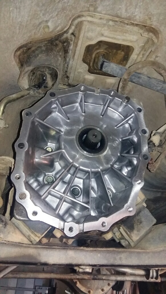

Good afternoon
My Patrol leaked oil between the gearbox and transfer case.
I removed the transfer case on Saturday and will replace both the gearbox seal and the t/case seal.
My question is: Should I use original Nissan seals or can I use aftermarket seals? I can get seals from Seal Centre in Pretoria.
Is Castrol ATF Dex III the correct oil to use in the t/case?
Thank you
Johan

The seals are in and the t/case is back in the car.
You have to do a bit of underthecar yoga to get to all the nuts and bolts but myself and Jack (that is trolley jack) managed to get it out and back in.
I also weighed the t/case and it is +-50kg wihout oil.
